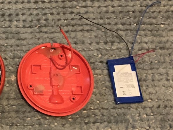

    • Starting with the main side of the speaker, turn it over so that the back side is visible.
  2. JBL Clip 1 Teardown: crwdns2935265:02crwdnd2935265:01crwdnd2935265:02crwdne2935265:0 JBL Clip 1 Teardown: crwdns2935265:02crwdnd2935265:02crwdnd2935265:02crwdne2935265:0
    • Pull off the rubber ring on the underside of the speaker so that the screws are visible.
    • Unscrew the small phillips screws.
  3. JBL Clip 1 Teardown: crwdns2935265:03crwdnd2935265:01crwdnd2935265:01crwdne2935265:0
    • Firmly pull the back cover off of the device.
    • Begin to unscrew the screws holding the front of the speaker in place.

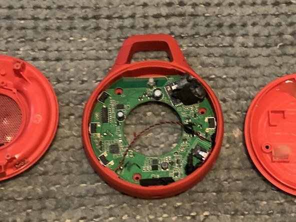

  4. JBL Clip 1 Teardown: crwdns2935265:04crwdnd2935265:01crwdnd2935265:03crwdne2935265:0 JBL Clip 1 Teardown: crwdns2935265:04crwdnd2935265:02crwdnd2935265:03crwdne2935265:0 JBL Clip 1 Teardown: crwdns2935265:04crwdnd2935265:03crwdnd2935265:03crwdne2935265:0
    • After unscrewing the 3 screws on the inside turn the speaker over so that the front is placing you.
    • Using a prying tool, pull up on the rim of the speaker front.
  5. JBL Clip 1 Teardown: crwdns2935265:05crwdnd2935265:01crwdnd2935265:02crwdne2935265:0 JBL Clip 1 Teardown: crwdns2935265:05crwdnd2935265:02crwdnd2935265:02crwdne2935265:0
    • Pull up to reveal the other side of the speaker chip and the speaker component itself.
    • Be careful of the wire connecting the speaker to the board as too much pressure may cause it to snap.
  6. JBL Clip 1 Teardown: crwdns2935265:06crwdnd2935265:01crwdnd2935265:02crwdne2935265:0 JBL Clip 1 Teardown: crwdns2935265:06crwdnd2935265:02crwdnd2935265:02crwdne2935265:0
    • Unscrew the speaker connecting to the front piece of plastic.
    • Pull the speaker off of the front piece.
  7. JBL Clip 1 Teardown: crwdns2935265:07crwdnd2935265:01crwdnd2935265:03crwdne2935265:0 JBL Clip 1 Teardown: crwdns2935265:07crwdnd2935265:02crwdnd2935265:03crwdne2935265:0 JBL Clip 1 Teardown: crwdns2935265:07crwdnd2935265:03crwdnd2935265:03crwdne2935265:0
    • Teardown is fully finished. There are only 5 main seperate components to the speaker!
