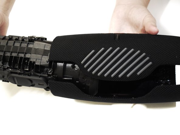

    • Ensure that the device is fully powered off and no cables are attached before proceeding with the repair.
    • This fabric cover is secured with plastic clips only. Depending on the model, the cover may be secured by both plastic clips and screws.
    • Insert the flat end of the Jimmy into the seam located between the fabric cover on the right side of the seam.
    • Pry upward on the fabric cover to release plastic clips on the right side of the seam.
  2. JBL Charge 5 Fabric Case Replacement: crwdns2935265:02crwdnd2935265:01crwdnd2935265:03crwdne2935265:0 JBL Charge 5 Fabric Case Replacement: crwdns2935265:02crwdnd2935265:02crwdnd2935265:03crwdne2935265:0 JBL Charge 5 Fabric Case Replacement: crwdns2935265:02crwdnd2935265:03crwdnd2935265:03crwdne2935265:0
    • Insert the flat end of the Jimmy into the seam between the fabric cover at the center of the seam and the left side of the seam.
    • Use the Jimmy to pry open the edge with the rubber texture, releasing the remaining plastic clips.
  3. JBL Charge 5 Fabric Case Replacement: crwdns2935265:03crwdnd2935265:01crwdnd2935265:03crwdne2935265:0 JBL Charge 5 Fabric Case Replacement: crwdns2935265:03crwdnd2935265:02crwdnd2935265:03crwdne2935265:0 JBL Charge 5 Fabric Case Replacement: crwdns2935265:03crwdnd2935265:03crwdnd2935265:03crwdne2935265:0
    • Use your hands to gently open the two halves of the casing and slide the fabric cover off of the interior housing.
