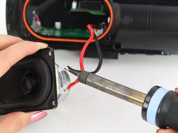

  15. JBL Charge 4 Motherboard Replacement: crwdns2935265:015crwdnd2935265:01crwdnd2935265:02crwdne2935265:0 JBL Charge 4 Motherboard Replacement: crwdns2935265:015crwdnd2935265:02crwdnd2935265:02crwdne2935265:0
    • Desolder the red and black wires.
    • A guide for soldering and desoldering can be found here.

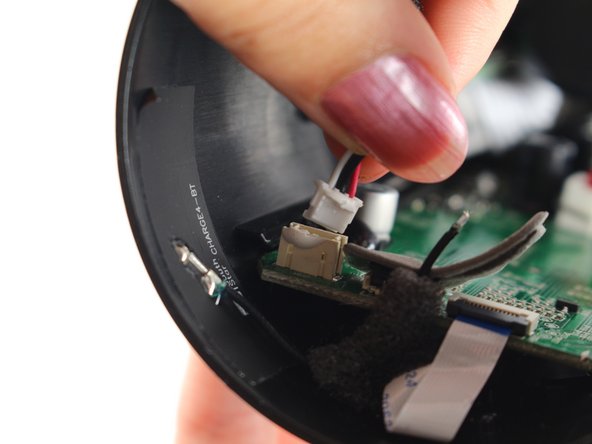

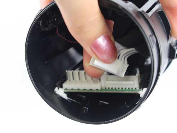

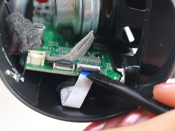

  16. JBL Charge 4 Motherboard Replacement, Motherboard: crwdns2935265:016crwdnd2935265:01crwdnd2935265:03crwdne2935265:0 JBL Charge 4 Motherboard Replacement, Motherboard: crwdns2935265:016crwdnd2935265:02crwdnd2935265:03crwdne2935265:0 JBL Charge 4 Motherboard Replacement, Motherboard: crwdns2935265:016crwdnd2935265:03crwdnd2935265:03crwdne2935265:0
    • Remove the wire harness coming from the port bay on the left side of the motherboard by gently lifting the connector from its housing.
    • Remove the white ribbon cable from the ZIF connector by lifting the black locking flap on the connector with a spudger or your fingernail.

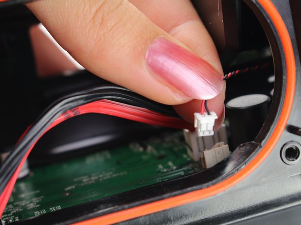

  17. JBL Charge 4 Motherboard Replacement: crwdns2935265:017crwdnd2935265:01crwdnd2935265:02crwdne2935265:0 JBL Charge 4 Motherboard Replacement: crwdns2935265:017crwdnd2935265:02crwdnd2935265:02crwdne2935265:0
    • Remove the ground cable harness next to the speaker wire by gentling pulling it from the connector.
  18. JBL Charge 4 Motherboard Replacement: crwdns2935265:018crwdnd2935265:01crwdnd2935265:02crwdne2935265:0 JBL Charge 4 Motherboard Replacement: crwdns2935265:018crwdnd2935265:02crwdnd2935265:02crwdne2935265:0
    • Flip the speaker around to the other side.
    • Remove the wiring harness leading to the port bay by pressing down on the tab and gently pulling the harness from the connector.

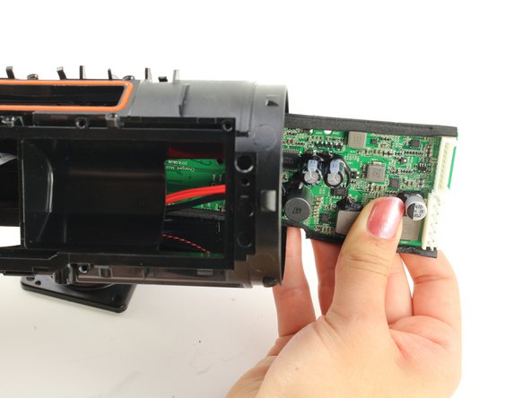

  19. JBL Charge 4 Motherboard Replacement: crwdns2935265:019crwdnd2935265:01crwdnd2935265:03crwdne2935265:0 JBL Charge 4 Motherboard Replacement: crwdns2935265:019crwdnd2935265:02crwdnd2935265:03crwdne2935265:0 JBL Charge 4 Motherboard Replacement: crwdns2935265:019crwdnd2935265:03crwdnd2935265:03crwdne2935265:0
    • Push the motherboard from either side of the housing along its tracks.
    • Pull out the motherboard from the speaker housing.
    • When putting the motherboard back in the housing, ensure that it is between the two tracks on the top side of the speaker.

This guide has a vital flaw. Just look at the loose wire cause by a broken solder in image 16!
PAJ 101 - crwdns2934203:0crwdne2934203:0
that's the antenna cable which was pulled out of the connector. The step of popping the antenna connector out is missing.
