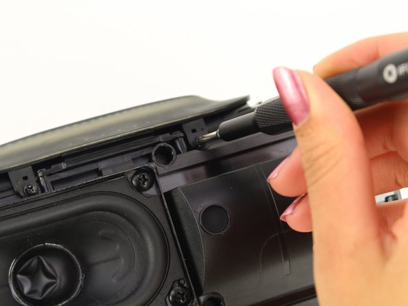

    • Flip your speaker over and insert the plastic opening tool into the slit on the grille.
    • Pry away from yourself towards the back of the speaker to release the clip.
    • Repeat this process for the clip on the other side.

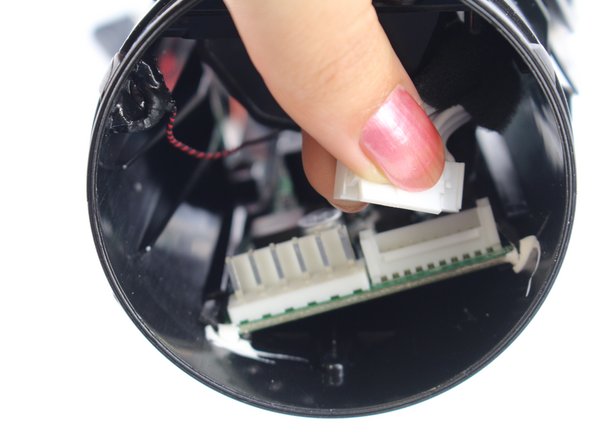

    • Before removing port bay you must detach the connecting tabs on either side of the device.
    • Press on the tab and gently pull out the wire connector.
  10. JBL Charge 4 Charging Port Bay Replacement: crwdns2935265:010crwdnd2935265:01crwdnd2935265:02crwdne2935265:0 JBL Charge 4 Charging Port Bay Replacement: crwdns2935265:010crwdnd2935265:02crwdnd2935265:02crwdne2935265:0
    • Remove the second connector on the opposite side by gently pulling it out.
  11. JBL Charge 4 Charging Port Bay Replacement: crwdns2935265:011crwdnd2935265:01crwdnd2935265:01crwdne2935265:0
    • Remove the port bay from the device and place the device to the side.

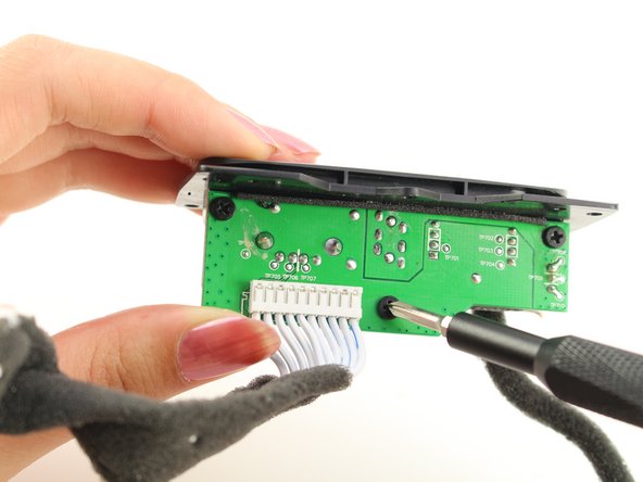

    • Remove the three 9mm Phillips #0 screws from the board.
  13. JBL Charge 4 Charging Port Bay Replacement: crwdns2935265:013crwdnd2935265:01crwdnd2935265:02crwdne2935265:0 JBL Charge 4 Charging Port Bay Replacement: crwdns2935265:013crwdnd2935265:02crwdnd2935265:02crwdne2935265:0

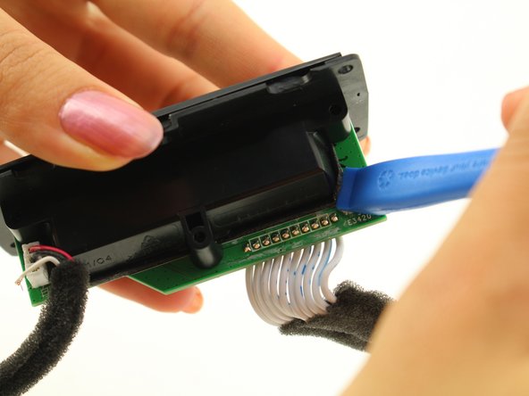

    • Using the plastic opening tool, lift the board from the port bay holder.
  14. JBL Charge 4 Charging Port Bay Replacement: crwdns2935265:014crwdnd2935265:01crwdnd2935265:02crwdne2935265:0 JBL Charge 4 Charging Port Bay Replacement: crwdns2935265:014crwdnd2935265:02crwdnd2935265:02crwdne2935265:0
