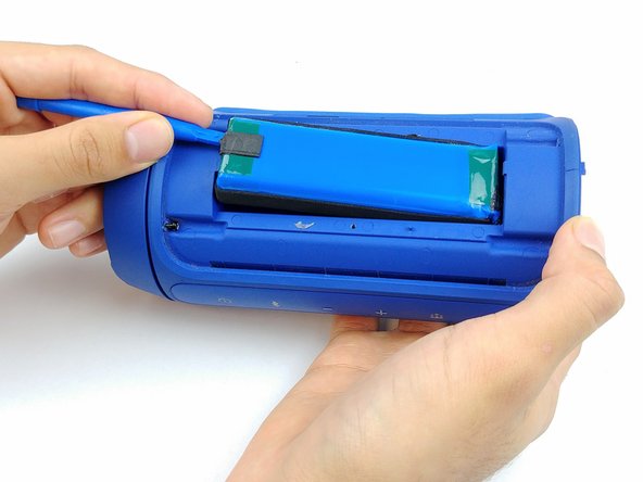

  5. JBL Charge 2 Battery Replacement: crwdns2935265:05crwdnd2935265:01crwdnd2935265:01crwdne2935265:0
    • Disconnect the battery connector with a plastic opening tool and wiggle the connector free.
  6. JBL Charge 2 Battery Replacement: crwdns2935265:06crwdnd2935265:01crwdnd2935265:03crwdne2935265:0 JBL Charge 2 Battery Replacement: crwdns2935265:06crwdnd2935265:02crwdnd2935265:03crwdne2935265:0 JBL Charge 2 Battery Replacement: crwdns2935265:06crwdnd2935265:03crwdnd2935265:03crwdne2935265:0
    • Scrape the battery wire sealant off with a plastic opening tool, and ensure it is free of the body of the speaker and wires.
    • Slide the battery free.

Thanks for the manual! Easy repair this way.
Jeroen Cox - crwdns2934203:0crwdne2934203:0
The JBL Charge 2 I have only needs the rear screen to be taken off. Once removed, just unscrew the battery holder plate. No need to unscrew the bass speakers. The battery plate is pretty well protected against water entering. You have to remove some silicone caulking to take out the power plug. My speaker takes the “New” Charge 2 battery.
