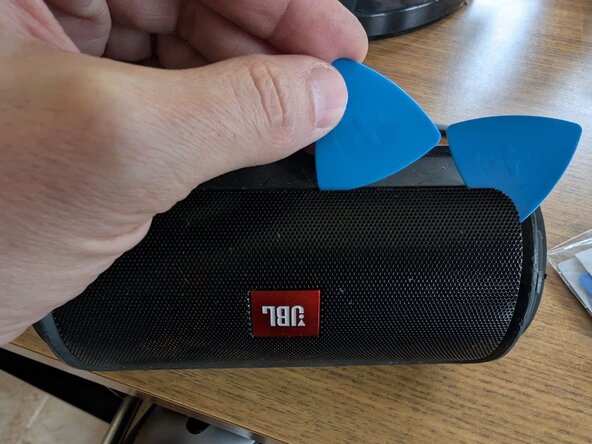

    • Remove the metal grill: starting from bottom-left corner, use a guitar pick or spudger to lift the metal grill.
    • *Pro-tip* if it feels like it's not moving, just be patient and do not try to use more force: apply a gentle continuous pressure and it will slowly starting coming off. Be patient.
    • Unscrew the four screws that hold each speaker in place (8 total).

How did you remove the IRON NET ?
Olivier - crwdns2934203:0crwdne2934203:0
http://bit.ly/1VlVWXH - First step in this guide. Hope this helps :)
