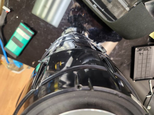

  6. JBL Boombox Battery Replacement, Remove the Mesh Cover - Rear: crwdns2935265:06crwdnd2935265:01crwdnd2935265:02crwdne2935265:0 JBL Boombox Battery Replacement, Remove the Mesh Cover - Rear: crwdns2935265:06crwdnd2935265:02crwdnd2935265:02crwdne2935265:0
    • Using your opening tool, pry into the back of the mesh cover where indicated to release the two catches.
    • When both catches are released, the back cover should hinge completely backwards and be completely open.
    • When reassembling, make sure these catches line up properly. Attempting to force them closed if not lined up properly can result in breakage and a loose mesh cover.
  7. JBL Boombox Battery Replacement, Remove the Mesh Cover - Front: crwdns2935265:07crwdnd2935265:01crwdnd2935265:02crwdne2935265:0 JBL Boombox Battery Replacement, Remove the Mesh Cover - Front: crwdns2935265:07crwdnd2935265:02crwdnd2935265:02crwdne2935265:0
    • Using your opening tool, pry into the front of the mesh cover where indicated to release the two catches.
    • When both catches are released, the front cover should hinge completely backwards and be completely open.
    • With both the back and front released, the mesh cover should easily lift away.
    • When reassembling, make sure these posts line up properly, as well. These posts are only on the front and ensure the mesh cover does not physically touch the speakers.
    • Attempting to force them closed if not lined up properly can result in distorted sound or damage to the speakers.

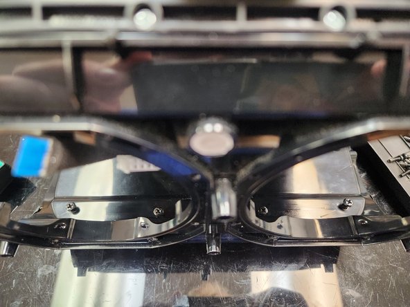

  8. JBL Boombox Battery Replacement, Remove the Tweeter Housing: crwdns2935265:08crwdnd2935265:01crwdnd2935265:02crwdne2935265:0 JBL Boombox Battery Replacement, Remove the Tweeter Housing: crwdns2935265:08crwdnd2935265:02crwdnd2935265:02crwdne2935265:0
    • There are six screws surrounding each side of the tweeter housing.
    • Unfortunately, due to the angles involved, it is impossible to take a photo that shows all six. Just know they are relatively evenly spaced out.
    • Remove all six screws from each side, twelve total.
    • Keep these screws separate, as they do not match screws used in other steps.
    • Once the screws are removed, be careful not to pull the housing away. The tweeter speakers are still physically connected to the motherboard, and pulling the housings away can damage these connections or the motherboard.
  9. JBL Boombox Battery Replacement, Disconnect the Tweeters: crwdns2935265:09crwdnd2935265:01crwdnd2935265:02crwdne2935265:0 JBL Boombox Battery Replacement, Disconnect the Tweeters: crwdns2935265:09crwdnd2935265:02crwdnd2935265:02crwdne2935265:0
    • After separating the tweeter housing, carefully disconnect the tweeters.
    • The left side has only one connection to disconnect.
    • The right side has two connections to disconnect.
    • There may be some adhesive such as hot glue securing these connections. If so, remove it before disconnecting to avoid damaging the wires.
    • Once both sides are disconnected, you are finished removing the tweeters.

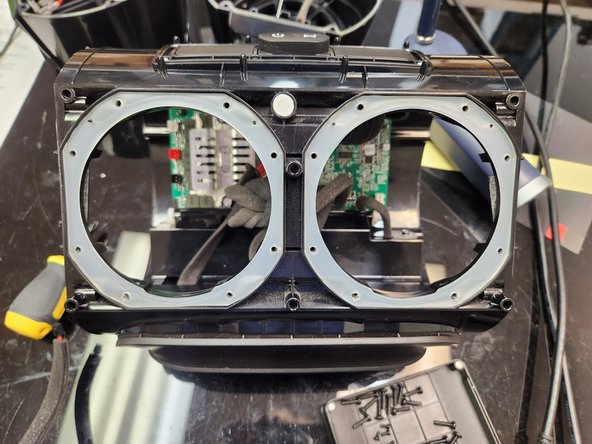

  12. JBL Boombox Battery Replacement, Remove the Speakers: crwdns2935265:012crwdnd2935265:01crwdnd2935265:01crwdne2935265:0
    • With the speakers disconnected and unscrewed, insert a hand in from the side where you removed the tweeter housing and gently push up from inside.
    • Using one hand to hold and lift the speakers, use your second hand inside the body of the Boombox to carefully guide the cable out of the hole, ensuring that it does not get caught and damaged on anything inside as it is removed.
    • Remember, the speaker with the red connection is on the left and the speaker with the black connection is on the right.
    • If for some reason your speakers are not color coded the same, use the photos in the guide to ensure the plugs are in the correct order and remember that the left speaker has a shorter cable and the right speaker has a longer cable.

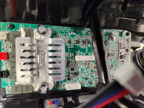

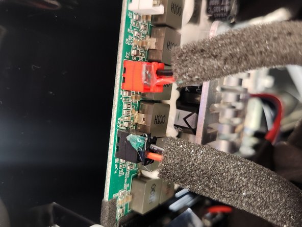

  14. JBL Boombox Battery Replacement, Disconnect the Motherboard: crwdns2935265:014crwdnd2935265:01crwdnd2935265:02crwdne2935265:0 JBL Boombox Battery Replacement, Disconnect the Motherboard: crwdns2935265:014crwdnd2935265:02crwdnd2935265:02crwdne2935265:0
    • After removing the tweeters and the speakers, you are ready to remove the motherboard.
    • There are two JST type connectors connecting the battery. Remove these by pulling firmly.
    • While it is generally advised to not pull on the wires of these types of connectors, the angles for working inside this device make it practically impossible to get a pry tool and remove the connectors in a safer manner.
    • Please take as much care as possible not to damage the wires or remove them from the connector housing.
    • There are four ribbon connectors connecting the various buttons and inputs. Make sure to release the brown locking tabs by pulling up on the sides before gently pulling the ribbon cables out.

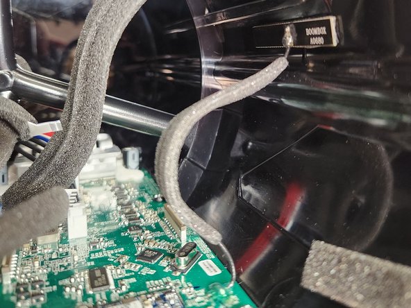

  15. JBL Boombox Battery Replacement, Remove the Antenna: crwdns2935265:015crwdnd2935265:01crwdnd2935265:02crwdne2935265:0 JBL Boombox Battery Replacement, Remove the Antenna: crwdns2935265:015crwdnd2935265:02crwdnd2935265:02crwdne2935265:0
    • The antenna is adhered to the top of the unit with a double sided adhesive. Gently peel this off to have the antenna dangle loosely by it's attachment to the motherboard.
    • Take care as the antenna is soldered directly to the motherboard and is not to be removed. This connection is delicate and can be broken easily.

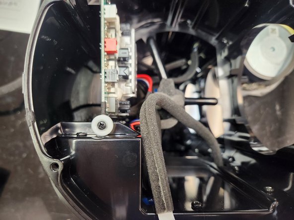

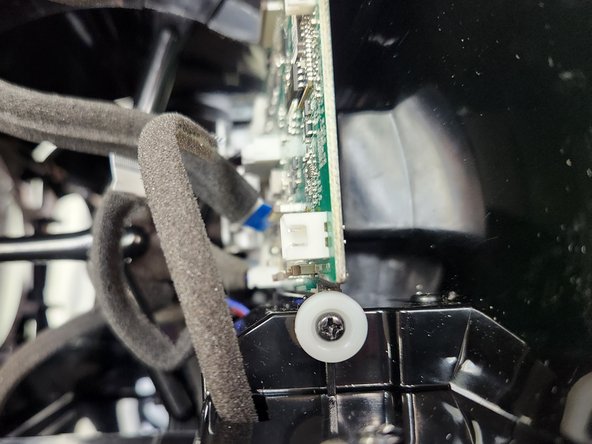

  17. JBL Boombox Battery Replacement, Unscrew the Motherboard Sides: crwdns2935265:017crwdnd2935265:01crwdnd2935265:02crwdne2935265:0 JBL Boombox Battery Replacement, Unscrew the Motherboard Sides: crwdns2935265:017crwdnd2935265:02crwdnd2935265:02crwdne2935265:0
    • On either side of the motherboard on the bottom, there is a single screw with a large white plastic washer.
    • Using your Phillips #2 Screwdriver, remove both of these screws.
  18. JBL Boombox Battery Replacement, Remove the Motherboard: crwdns2935265:018crwdnd2935265:01crwdnd2935265:02crwdne2935265:0 JBL Boombox Battery Replacement, Remove the Motherboard: crwdns2935265:018crwdnd2935265:02crwdnd2935265:02crwdne2935265:0
    • With all cables disconnected and all 5 screws removed, you are ready to remove the motherboard.
    • Using both hands, reach inside the frame from either side where the tweeter housing was. Gently but firmly grasp the motherboard on both sides and tilt it forward.
    • There is a notch in the PCB where the motherboard slots into a rib of the frame of the housing. The motherboard must be carefully tilted forward past this notch.
    • Once it is tilted forward far enough, the motherboard can be removed by lifting upwards.
    • If it is not wanting to budge, focusing your efforts on one side at a time in a gentle rocking rhythm can help loosen the friction holding the motherboard in place.

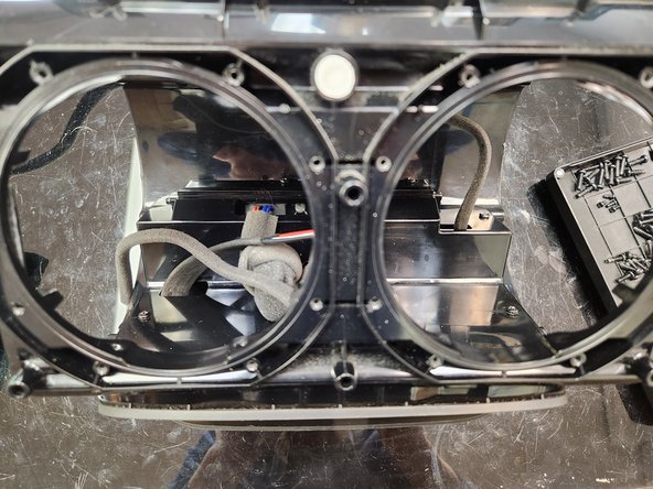

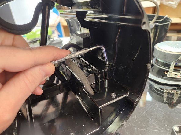

  19. JBL Boombox Battery Replacement, Remove the four Front Screws: crwdns2935265:019crwdnd2935265:01crwdnd2935265:02crwdne2935265:0 JBL Boombox Battery Replacement, Remove the four Front Screws: crwdns2935265:019crwdnd2935265:02crwdnd2935265:02crwdne2935265:0
    • With the motherboard removed, you are finally ready to remove the battery compartment and change the battery.
    • Using your Phillips #2 screwdriver, remove the four front screws.
    • Keep these screws separate, as they do not match screws used in other steps. However, all 10 screws securing the battery compartment can be freely mixed and matched as they are identical.
    • The front screws are very near edges and, depending on the thickness and length of your screwdriver, might not be accessible with a conventional screwdriver.
    • If you are having trouble with a conventional screwdriver, use your right angle screwdriver. It takes longer and is more difficult, but if you strip these screws, you could be locked out of the battery compartment forever. You do not have the angles or leverage to use proper screw extractors.
  20. JBL Boombox Battery Replacement, Remove the two Center Screws: crwdns2935265:020crwdnd2935265:01crwdnd2935265:02crwdne2935265:0 JBL Boombox Battery Replacement, Remove the two Center Screws: crwdns2935265:020crwdnd2935265:02crwdnd2935265:02crwdne2935265:0
    • Using your Phillips #2 screwdriver, remove the two center screws.
    • The center screws have very little vertical clearance; depending on the length of your screwdriver, they might not be accessible.
  21. JBL Boombox Battery Replacement, Remove the four Rear Screws: crwdns2935265:021crwdnd2935265:01crwdnd2935265:03crwdne2935265:0 JBL Boombox Battery Replacement, Remove the four Rear Screws: crwdns2935265:021crwdnd2935265:02crwdnd2935265:03crwdne2935265:0 JBL Boombox Battery Replacement, Remove the four Rear Screws: crwdns2935265:021crwdnd2935265:03crwdnd2935265:03crwdne2935265:0
    • Using your right angle screwdriver, remove the 4 rear screws.
    • The rear screws are very near edges and will, without question, not be accessible with a conventional screwdriver. You MUST use a right angle screwdriver to avoid stripping these screws.

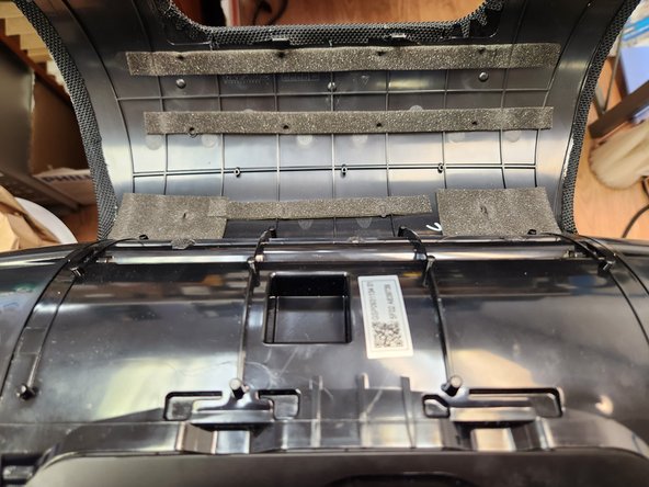

  22. JBL Boombox Battery Replacement, Open the Battery Compartment: crwdns2935265:022crwdnd2935265:01crwdnd2935265:02crwdne2935265:0 JBL Boombox Battery Replacement, Open the Battery Compartment: crwdns2935265:022crwdnd2935265:02crwdnd2935265:02crwdne2935265:0
    • Once all 10 screws holding the battery compartment in place are removed, you are ready to access the battery.
    • Slowly and carefully, keeping an eye on all the cables inside the housing to make sure nothing gets caught and damaged, keep the bottom of the battery compartment flat on the work surface and tilt the housing backwards.
    • It should tilt and the cables should all go out through their respective holes. Make sure to completely remove the battery cable. All other cables should be safe to remain partially through their holes and the device will rest as pictured.
    • When reassembling, make sure to pull as much slack from the cables through the holes as possible. Not doing so can result in cables too short to reach the proper spot on the motherboard, or potentially damaged cables.
    • At this point, the battery may only held in by friction, or it may have adhesive similar to the antenna in step 15. Either way, carefully pull the battery out and you are ready to install your new one!
Take extra care to not get any cables caught behind the motherboard.
Take extra care that all cables from the battery compartment are pulled into the main housing fully before screwing shut.
