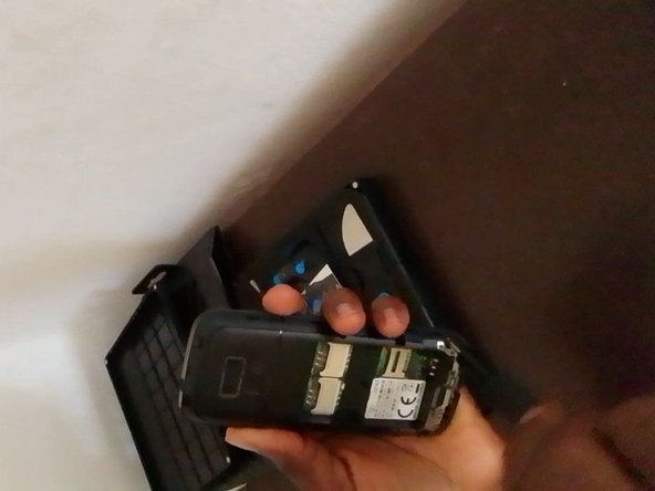

    • First switch off the phone by longpressing the power button.

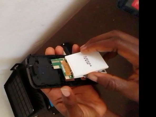

  2. Itel 2163 Disassembly, Remove Back Cover and Battery: crwdns2935265:02crwdnd2935265:01crwdnd2935265:03crwdne2935265:0 Itel 2163 Disassembly, Remove Back Cover and Battery: crwdns2935265:02crwdnd2935265:02crwdnd2935265:03crwdne2935265:0 Itel 2163 Disassembly, Remove Back Cover and Battery: crwdns2935265:02crwdnd2935265:03crwdnd2935265:03crwdne2935265:0
    • Remove the back cover of the phone and the battery, then check for any available sim card(s), and eject the sim card(s) from the sim bed(s).

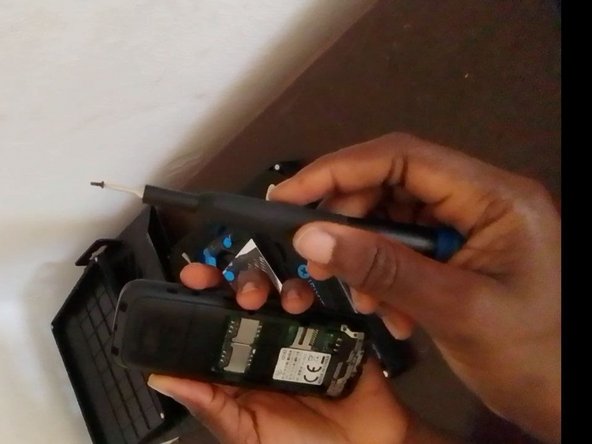

  3. Itel 2163 Disassembly, Unscrew the Nuts: crwdns2935265:03crwdnd2935265:01crwdnd2935265:03crwdne2935265:0 Itel 2163 Disassembly, Unscrew the Nuts: crwdns2935265:03crwdnd2935265:02crwdnd2935265:03crwdne2935265:0 Itel 2163 Disassembly, Unscrew the Nuts: crwdns2935265:03crwdnd2935265:03crwdnd2935265:03crwdne2935265:0
    • Get the phillips #00 screwdriver and check for the available four (4) nuts/screws attaching the front and middle case together.

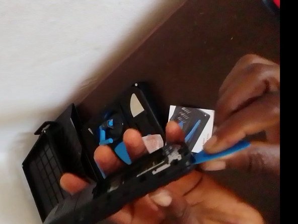

  4. Itel 2163 Disassembly, Pry the Phone open: crwdns2935265:04crwdnd2935265:01crwdnd2935265:03crwdne2935265:0 Itel 2163 Disassembly, Pry the Phone open: crwdns2935265:04crwdnd2935265:02crwdnd2935265:03crwdne2935265:0 Itel 2163 Disassembly, Pry the Phone open: crwdns2935265:04crwdnd2935265:03crwdnd2935265:03crwdne2935265:0
    Plastic Cards
    $2.99
    • Get a plastic card and slice open the phone at the rear end towards the charging port in order to separate the middle case (sim bed case) from the front case (screen case).
    • Do not pry the phone open with your finger, it is not safe and ethical as you can injure your finger nail in the process.

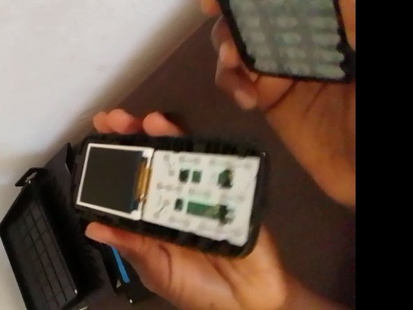

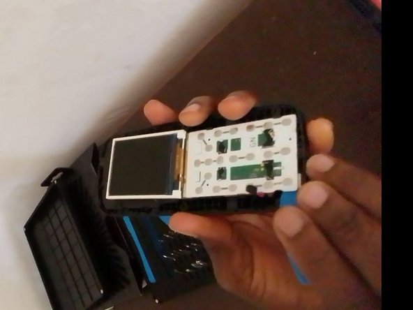

  5. Itel 2163 Disassembly, The Motherboard in view: crwdns2935265:05crwdnd2935265:01crwdnd2935265:03crwdne2935265:0 Itel 2163 Disassembly, The Motherboard in view: crwdns2935265:05crwdnd2935265:02crwdnd2935265:03crwdne2935265:0 Itel 2163 Disassembly, The Motherboard in view: crwdns2935265:05crwdnd2935265:03crwdnd2935265:03crwdne2935265:0
    • After prying the phone open, you will then be left with the motherboard and screen in view. Attached to the motherboard, you'll see the charging port, the mic, the speaker, the earphone jack, etc.
    • Be careful with handling of the screen so as not to cause any defect to the screen flex thereby making the screen to malfunction or not work again.
To reassemble this device, follow these instructions in reverse order.
