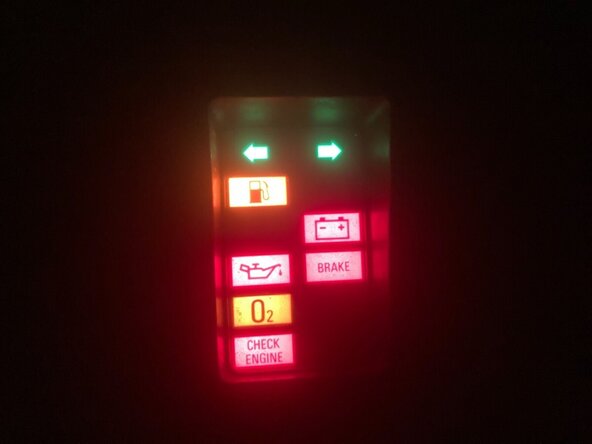

    • If a problem develops in a monitored system with the engine running, the Check Engine light (CEL) will come ON and a trouble code will be stored in ECM memory.
    • As long as a problem is present, the light will remain on while the engine is running. If the problem is intermittent, the light will go out but a trouble code will be stored in ECM memory.
    • As a bulb check, the Check Engine light will come on with the ignition switched on and the engine not running. If no codes are present, the light will go out upon starting the engine. If the light remains on, the system has detected a fault.

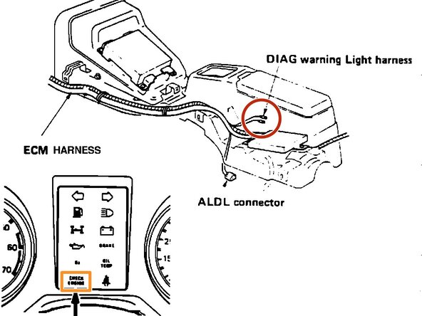

  2. Isuzu Trooper Check Engine Light Trouble Code Reading, How to access trouble codes: crwdns2935265:02crwdnd2935265:01crwdnd2935265:01crwdne2935265:0
    • To access trouble codes, a test lead (white wire) and ground lead (black wire) are branched from the wiring harness under the center console near the ECM.
    • With the ignition "ON" connect these two leads together.
    • The "Check Engine" light will begin to flash code 12. Code 12 consists of one flash, a short pause, then two flashes. After a longer pause, code 12 will repeat two more times.
    • This check indicates that the on-board diagnostic system is functioning. If no other codes are present, the cycle will repeat until the ignition is switched "OFF."

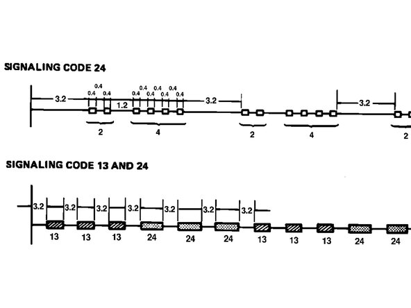

  3. Isuzu Trooper Check Engine Light Trouble Code Reading, How to read trouble codes: crwdns2935265:03crwdnd2935265:01crwdnd2935265:01crwdne2935265:0
    • If trouble codes are stored in memory, the lowest number code will flash three times followed by the next higher code number until all stored codes have been displayed.
    • The codes will then repeat in the same order until the test lead is disconnected. Code 14, for example, indicates a problem in the coolant sensor circuit.
    • To clear a code from memory, disconnect the battery.
