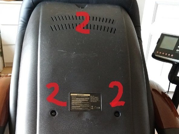

  3. Irest SL A28-1 Massage Chair Jerking Bump Fix, Remove the screws: crwdns2935265:03crwdnd2935265:01crwdnd2935265:02crwdne2935265:0 Irest SL A28-1 Massage Chair Jerking Bump Fix, Remove the screws: crwdns2935265:03crwdnd2935265:02crwdnd2935265:02crwdne2935265:0
    • Remove the screw for the cord inlet (Marked as 1) and remove the cord cover
    • Remove the 5 screws (marked 2) for the back cover - Please note they are NOT all the same size, so pay attention to the positions

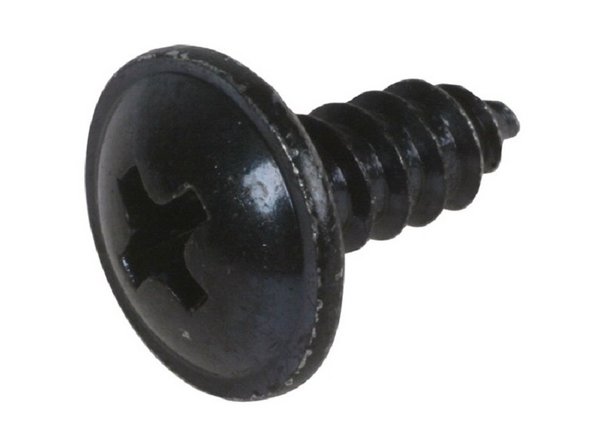

    • I tightened the strap at the botton of the frame, because this is where I had space to manouvre
    • I positioned the strap more to the left so it got centered
    • I used a 1.5 mm drill to prepare a whole in the frame so the plate screw (See picture 2) does not rapture the woodden frame
    • I used a plate screw to secure the strap in the new position
