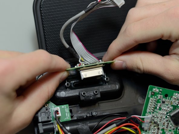

    1. Internal Audio Adapter Jack Replacement, Internal Audio Adapter Jack: crwdns2935265:08crwdnd2935265:01crwdnd2935265:01crwdne2935265:0
      • A strip of black tape covers the grey and purple wire cluster that connects to the internal audio printed circuit board. Carefully peel this tape away.
    2. Internal Audio Adapter Jack Replacement: crwdns2935265:09crwdnd2935265:01crwdnd2935265:01crwdne2935265:0
      • Remove the four 7 mm screws that hold the PCB in place; you will need a Phillips #1 driver to do this. You may need to move some wires out of the way to access one of these screws.
    3. Internal Audio Adapter Jack Replacement: crwdns2935265:010crwdnd2935265:01crwdnd2935265:02crwdne2935265:0 Internal Audio Adapter Jack Replacement: crwdns2935265:010crwdnd2935265:02crwdnd2935265:02crwdne2935265:0
      • Carefully lift and remove the black plastic bracket.
      • Lift the PCB away from the rest of the device.
