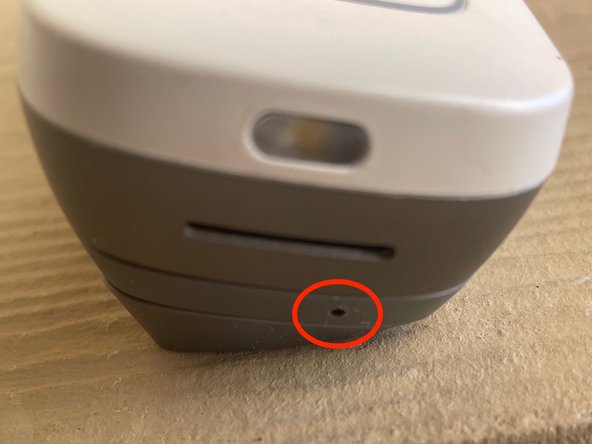

    • push a thin paper clip or small drill bit held with pliers into this hole on the bottom of the doorbell mount plate and pull up on the doorbell mechanism, which will release it from the mount.

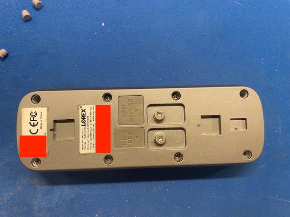

  2. Intermittant Lorex wired doorbell 2K 4K camera repair, Remove plugs and screws: crwdns2935265:02crwdnd2935265:01crwdnd2935265:02crwdne2935265:0 Intermittant Lorex wired doorbell 2K 4K camera repair, Remove plugs and screws: crwdns2935265:02crwdnd2935265:02crwdnd2935265:02crwdne2935265:0
    • Remove the 8 rubber plugs and the 8 philips screws below them, gently separate the two halves

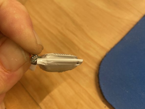

  3. Intermittant Lorex wired doorbell 2K 4K camera repair, Check for outgassing/inflated battery: crwdns2935265:03crwdnd2935265:01crwdnd2935265:02crwdne2935265:0 Intermittant Lorex wired doorbell 2K 4K camera repair, Check for outgassing/inflated battery: crwdns2935265:03crwdnd2935265:02crwdnd2935265:02crwdne2935265:0
    • The problem is caused by the battery swelling (located under the RF antenna by the pen in the first photo). The second photo shows the swollen battery after removal. The swelling of the battery causes the front and rear of the enclosure to separate and open the connection from the bottom housing to the circuit board, as seen in the next step

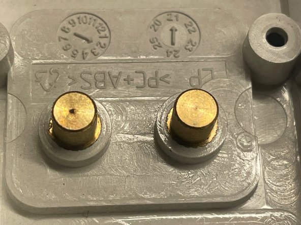

  4. Intermittant Lorex wired doorbell 2K 4K camera repair, Check for pitted post/pin connections: crwdns2935265:04crwdnd2935265:01crwdnd2935265:02crwdne2935265:0 Intermittant Lorex wired doorbell 2K 4K camera repair, Check for pitted post/pin connections: crwdns2935265:04crwdnd2935265:02crwdnd2935265:02crwdne2935265:0
    • Here, you can see the contacts on the front PCB and matching posts from the rear piece (screws on backside) with a bit of surface pitting caused by the posts not making contact with the PCB pins. The 24VAC doorbell actuation current measures around 1A, the poor connection resulted in the pitting at the posts.
  5. Intermittant Lorex wired doorbell 2K 4K camera repair, If needed, add wire connections post to pin: crwdns2935265:05crwdnd2935265:01crwdnd2935265:01crwdne2935265:0
    • If your posts are pitted, you can just directly solder a wire between each pin and post as shown in the first photo. This may not be necessary if your connection is restored simply by removing the puffy battery (button will illuminate when 16-24VAC is applied to backside screws and unit held together).
    • Taking out the puffed battery may be sufficient to let the pin-to-post contacts close, that didn't work on my unit, so I soldered wires from post to matching pin, although polarity doesn't matter, since it's the 24VAC input supply.
    • Use caution soldering the pegs pressed into the back housing so you don't melt the plastic or change the angle or position of the brass pegs so the unit won't close fully.
  6. Intermittant Lorex wired doorbell 2K 4K camera repair, Remove old battery: crwdns2935265:06crwdnd2935265:01crwdnd2935265:01crwdne2935265:0
    • Now, to remove the battery, gently separate the antenna from the puffy battery below, and then the puffy battery from the PCB. If you reinstall everything without the battery, the video camera will work and the doorbell will light up (blue for powered on, green for RF link and operation).
    • But without the battery, the inside doorbell won't ring when the button is pressed. The battery provides power to the PCB when the doorbell is pushed.
    • 16-24VAC is only present with the doorbell switch is open - it goes to 0V when the doorbell switch is briefly closed to complete the circuit to ring the doorbell, during which time the 3.7V battery provides continuous voltage to the electronics on the PCB which close an electronic switch. The battery is charged by the 16-24VAC input.
    • This is primarily a mechanical failure - The battery is probably in early stage of electrical failure as evidenced by the outgassing, this one is putting out correct 3.7V and plenty of current capacity from my measurements. The outgassing pushes the two halves of the doorbell apart, opening the 24V contacts as shown earlier.

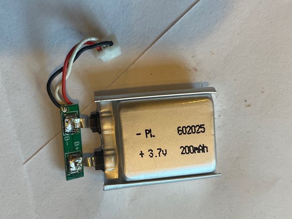

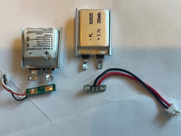

  7. Intermittant Lorex wired doorbell 2K 4K camera repair, Compare old and new battery: crwdns2935265:07crwdnd2935265:01crwdnd2935265:01crwdne2935265:0
    • The puffed-out battery on top is marked p/n 652023 with three pin connector, the replacement battery is the same size mechanically and electrically, available on amazon and others 602025 with a two terminal connector: https://www.amazon.com/dp/B07C9R84QS . We'll remove the 3 wire harness from the old battery and put it on the new one.
  8. Intermittant Lorex wired doorbell 2K 4K camera repair, move harness and pcb to new battery: crwdns2935265:08crwdnd2935265:01crwdnd2935265:03crwdne2935265:0 Intermittant Lorex wired doorbell 2K 4K camera repair, move harness and pcb to new battery: crwdns2935265:08crwdnd2935265:02crwdnd2935265:03crwdne2935265:0 Intermittant Lorex wired doorbell 2K 4K camera repair, move harness and pcb to new battery: crwdns2935265:08crwdnd2935265:03crwdnd2935265:03crwdne2935265:0
    • We'll remove the small circuit board and harness as a single unit from the old battery and install it on the new battery. The battery terminals are large, be sure to observe polarity (both battery and circuit board are marked + and -), it's straightforward if you have soldering experience.
    • Fold over the circuit board and put some new Kapton tape over the assembly after the third photo, and it's ready to be reinstalled.

Also getting the small pcb off the puffed battery is impossible, so I resorted to unfolding both and cutting then soldering the trimmed terminals from the new battery to the trimmed terminals from the existing old battery (Of note also is my replacement battery was a 602025 with 3.7v 300mAh and 1.1Wh available here: https://a.co/d/istvWDH - and I can conclude that what matters out of this is the size of the battery being the same in order to fit and the voltage, so don't worry if a higher amperage and wattage).
