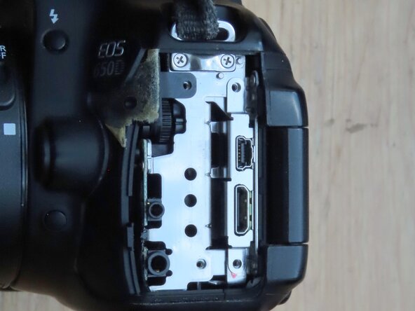

      • Remove the battery from the camera before beginning.
      • If you want to remove the remains of the rubber straps that once held the I/F terminal caps, do it before disassembly. They will disappear into the depths of the camera body once you remove the left cover.
      • To remove the remains of a rubber strap, pull it out as far as possible using tweezers, a needle or a small flat-tip srew driver. Then grab it from the side with small needle nose pliers. Twist the pliers to wrap the end of the strap around the pliers and pull it out.
      • Working this way instead of just pulling straight out allows you to apply more force while reducing the risk of tearing off the rubber.
    1. Interface Terminal Rubber Caps, Remove the grip rubber cover: crwdns2935265:02crwdnd2935265:01crwdnd2935265:01crwdne2935265:0
      • You will need to pry off the grip rubber to get at the screws underneath. Use your fingernails or a spudger. Starting in the lower right corner worked best for me. You may stop once the gap around the interface terminal cover is visible (green line).
      • Cut along the gap through any residue of the adhesive film.
    2. Interface Terminal Rubber Caps, Removing the interface terminal cover: crwdns2935265:03crwdnd2935265:01crwdnd2935265:02crwdne2935265:0 Interface Terminal Rubber Caps, Removing the interface terminal cover: crwdns2935265:03crwdnd2935265:02crwdnd2935265:02crwdne2935265:0
      • Unscrew the four #6 Torx screws that were hidden under the grip rubber.
      • Pry off the cover, starting at the cut-out near the strap holder.
    3. Interface Terminal Rubber Caps, Inserting the interface terminal caps: crwdns2935265:04crwdnd2935265:01crwdnd2935265:01crwdne2935265:0
      • Fully insert the replacements caps into the cover. Then put the cover back on the camera body while holding the caps in place and at the same time making sure that the straps go into the right openings in the body (red boxes).
  • Screw the interface terminal cover to the camera body. Do not overtighten the screws.
  • Replacing the grip rubber is left as an exercise to the reader. If you are lucky, the original adhesive film will still work.
