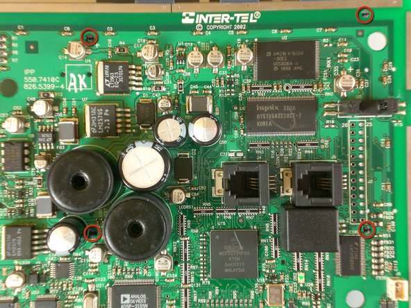

  2. Inter-tel IP 8660 Motherboard Replacement: crwdns2935265:02crwdnd2935265:01crwdnd2935265:03crwdne2935265:0 Inter-tel IP 8660 Motherboard Replacement: crwdns2935265:02crwdnd2935265:02crwdnd2935265:03crwdne2935265:0 Inter-tel IP 8660 Motherboard Replacement: crwdns2935265:02crwdnd2935265:03crwdnd2935265:03crwdne2935265:0
    • Unscrew the 9 highlighted screws using a #1 Phillips head screwdriver. You can use a magnetized screwdriver to draw them out.
    • 8 mm long
    • 11 mm long

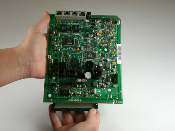

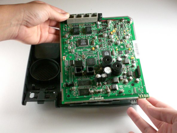

  6. Inter-tel IP 8660 Motherboard Replacement, LCD Screen: crwdns2935265:06crwdnd2935265:01crwdnd2935265:03crwdne2935265:0 Inter-tel IP 8660 Motherboard Replacement, LCD Screen: crwdns2935265:06crwdnd2935265:02crwdnd2935265:03crwdne2935265:0 Inter-tel IP 8660 Motherboard Replacement, LCD Screen: crwdns2935265:06crwdnd2935265:03crwdnd2935265:03crwdne2935265:0
    • Lift up the motherboard out of its housing in the front cover of the phone.
    • Set the front cover and button pads aside.

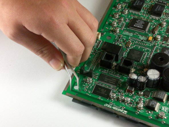

  7. Inter-tel IP 8660 Motherboard Replacement: crwdns2935265:07crwdnd2935265:01crwdnd2935265:03crwdne2935265:0 Inter-tel IP 8660 Motherboard Replacement: crwdns2935265:07crwdnd2935265:02crwdnd2935265:03crwdne2935265:0 Inter-tel IP 8660 Motherboard Replacement: crwdns2935265:07crwdnd2935265:03crwdnd2935265:03crwdne2935265:0
    • Using tweezers, pinch the highlighted connective clips together and depress. Start with the clips in the middle of the motherboard first.
    • Note: There are four clips, one at each corner of the LCD screen.

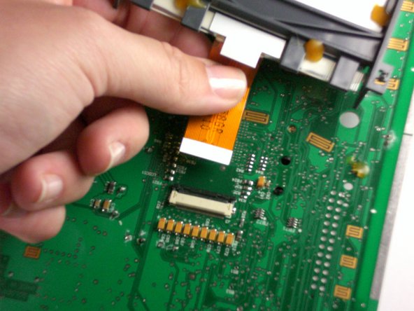

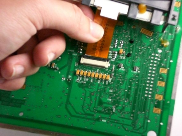

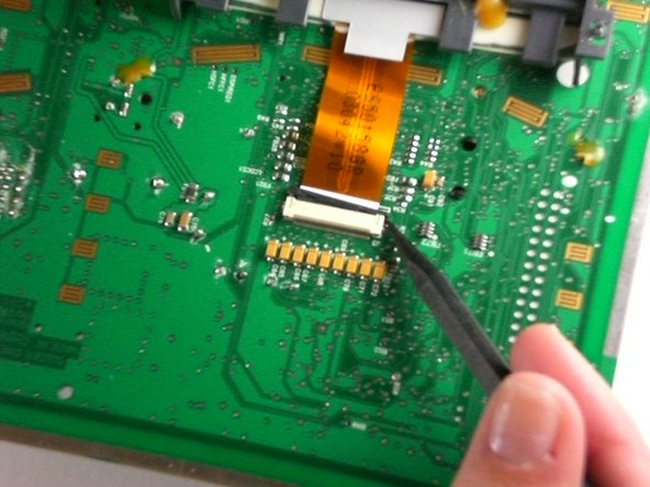

  9. Inter-tel IP 8660 Motherboard Replacement: crwdns2935265:09crwdnd2935265:01crwdnd2935265:02crwdne2935265:0 Inter-tel IP 8660 Motherboard Replacement: crwdns2935265:09crwdnd2935265:02crwdnd2935265:02crwdne2935265:0
    • Push the black clip holding the ribbon cable out of its casing using the plastic opening tool.
    • This is done using the spudger to lift one side out of its housing.
    • Reposition the spudger to the other side of the black clip and push it flush with the other end.
    • Note: The black clip pushes out of the housing and does not come completely loose.
  10. Inter-tel IP 8660 Motherboard Replacement: crwdns2935265:010crwdnd2935265:01crwdnd2935265:03crwdne2935265:0 Inter-tel IP 8660 Motherboard Replacement: crwdns2935265:010crwdnd2935265:02crwdnd2935265:03crwdne2935265:0 Inter-tel IP 8660 Motherboard Replacement: crwdns2935265:010crwdnd2935265:03crwdnd2935265:03crwdne2935265:0
    • Pull gently on the ribbon cable so that it comes loose from the black clip.
