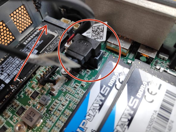

    • Lift the door, and keep an eye on the cables that connect to the NUC's motherboard. These cables are the power and data cables for the 2.5" hard drive bay.
    • Carefully unplug the cables from the motherboard, and set the bracket aside.
    • In the last photo, the slot for a blade SSD is marked with a red arrow. This is where you would install the blade SSD, and use a screw to hold it in place.

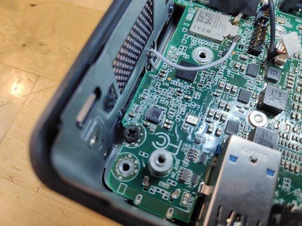

    • Remove the WiFi and Bluetooth antenna cables (be extremely careful when doing this otherwise you risk to rip the base contact terminal off the PCB)
    • Remove the stereo mic cable from the motherboard connector.
    • Pay attetion to the WiFi cable hidden under a black piece of tape
    • Disconnect mic cable

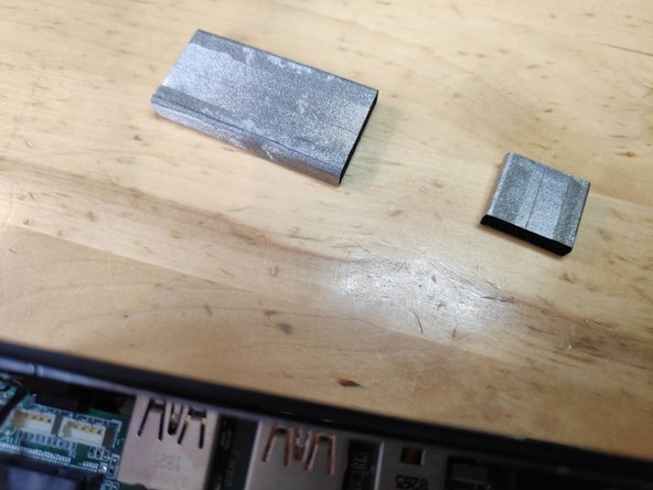

    • Remove padders from the sides
  8. Intel NUC8i7BEH Disassembly, Remove protection padding, continued: crwdns2935265:011crwdnd2935265:01crwdnd2935265:02crwdne2935265:0 Intel NUC8i7BEH Disassembly, Remove protection padding, continued: crwdns2935265:011crwdnd2935265:02crwdnd2935265:02crwdne2935265:0
    • Not all are necessary only the two depicted.

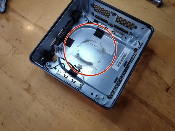

    • Use a pry tool to lift the motherboard from the casing
    • Marked with red circles the dust signs evident on first sight
