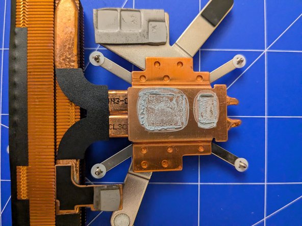

  9. Intel NUC11TNKi5 CPU Fan Replacement, Remove the fan passive block: crwdns2935265:09crwdnd2935265:01crwdnd2935265:02crwdne2935265:0 Intel NUC11TNKi5 CPU Fan Replacement, Remove the fan passive block: crwdns2935265:09crwdnd2935265:02crwdnd2935265:02crwdne2935265:0
    • Unscrew 4 screws holding the fan passive block.
    • Remove the passive block. Be aware there is a thermal paste below.
  10. Intel NUC11TNKi5 CPU Fan Replacement, Clean old thermal paste: crwdns2935265:010crwdnd2935265:01crwdnd2935265:03crwdne2935265:0 Intel NUC11TNKi5 CPU Fan Replacement, Clean old thermal paste: crwdns2935265:010crwdnd2935265:02crwdnd2935265:03crwdne2935265:0 Intel NUC11TNKi5 CPU Fan Replacement, Clean old thermal paste: crwdns2935265:010crwdnd2935265:03crwdnd2935265:03crwdne2935265:0
    • Apply isopropyl alcohol (at least 90% purity) to cotton swabs.
    • Remove the old thermal paste form chips by using cotton swabs. Repeat cleaning until all paste is removed.
    • Remove the old thermal paste form passive block by using cotton swabs. Repeat cleaning until all paste is removed.
  11. Intel NUC11TNKi5 CPU Fan Replacement, Apply new thermal paste: crwdns2935265:011crwdnd2935265:01crwdnd2935265:01crwdne2935265:0
    • Apply new thermal paste on marked chips. Use small amount of paste and spread it with a firm paper. Do not apply any thermal paste on passive block.
  12. Intel NUC11TNKi5 CPU Fan Replacement, Put back the fan passive block: crwdns2935265:012crwdnd2935265:01crwdnd2935265:01crwdne2935265:0
    • Carefully, put back the passive block.
    • Screw 4 screws.
