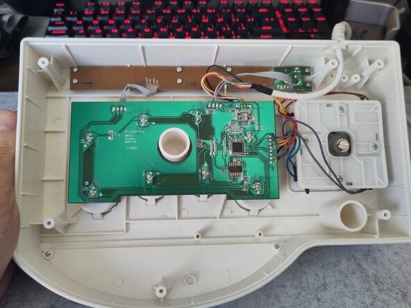

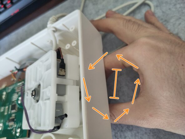

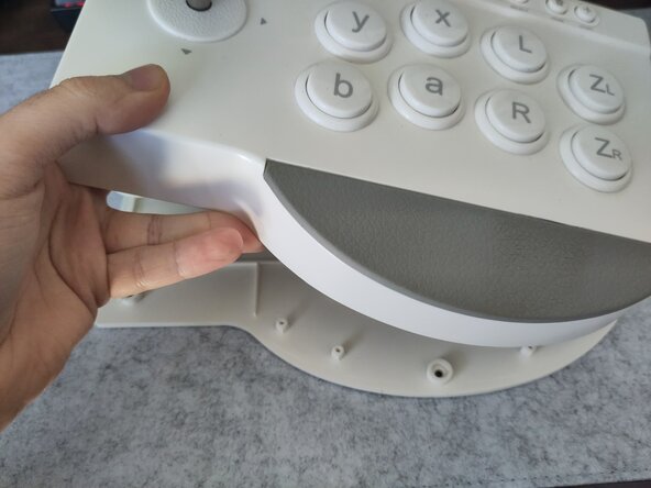

    • Remove the six Phillips-head screws under the rubber feet around the bottom of the case.
    • Flip the case right-side up, and lift up the top to remove the bottom plate.
    • There are four main components underneath:
    • The main PCB, which holds the main buttons, surface-mounted chips, and connections to the other three components.
    • the joystick, connected to the main PCB by eight wires soldered to each part of the stick's microswitches.
    • the turbo daughterboard, a small PCB with a switch and an LED, wired to the main PCB, intended to enable turbo functionality on the main buttons.
    • the menu button daughterboard, a long PCB with three small push buttons, with a simple ground connection back to the main PCB.

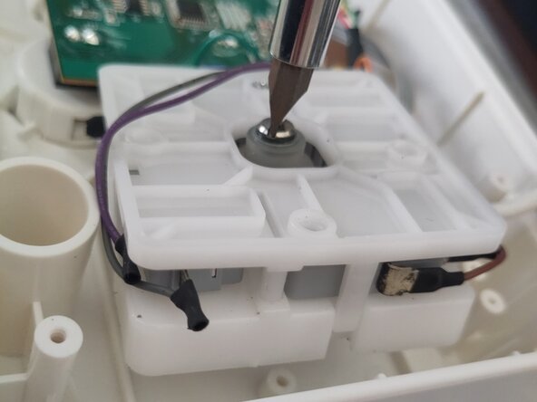

  2. Intec Combat Arcade Stick for Nintendo Wii Teardown, Joystick: crwdns2935265:02crwdnd2935265:01crwdnd2935265:03crwdne2935265:0 Intec Combat Arcade Stick for Nintendo Wii Teardown, Joystick: crwdns2935265:02crwdnd2935265:02crwdnd2935265:03crwdne2935265:0 Intec Combat Arcade Stick for Nintendo Wii Teardown, Joystick: crwdns2935265:02crwdnd2935265:03crwdnd2935265:03crwdne2935265:0
    • The restrictor gate is held in place by 4 Phillips-head screws.
    • The grey balltop can be removed by inserting a flat screw driver in the line-shaped divot in the middle, then use your hand on the other side to unscrew.

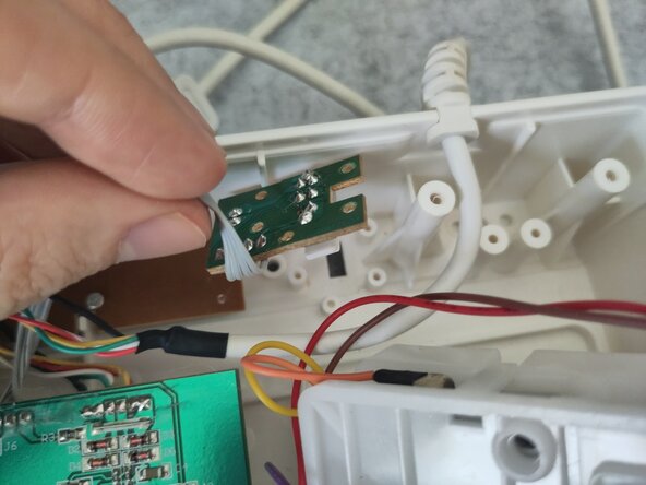

  3. Intec Combat Arcade Stick for Nintendo Wii Teardown, Turbo Daughterboard: crwdns2935265:03crwdnd2935265:01crwdnd2935265:02crwdne2935265:0 Intec Combat Arcade Stick for Nintendo Wii Teardown, Turbo Daughterboard: crwdns2935265:03crwdnd2935265:02crwdnd2935265:02crwdne2935265:0
    • The little circuit board holding the turbo switch and LED is held in place by 3 Phillips-head screws.

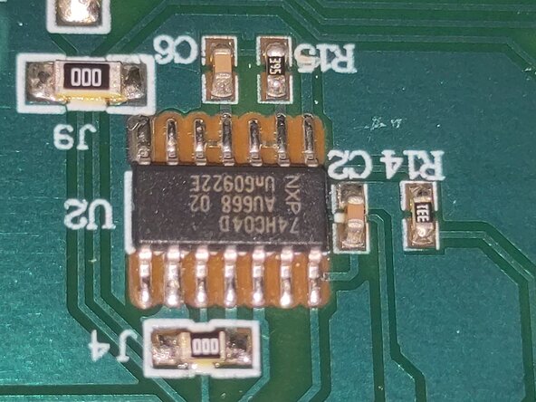

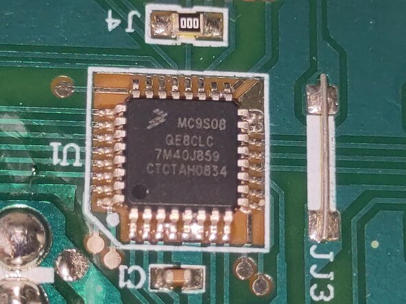

  5. Intec Combat Arcade Stick for Nintendo Wii Teardown, Circuit Board: crwdns2935265:05crwdnd2935265:01crwdnd2935265:03crwdne2935265:0 Intec Combat Arcade Stick for Nintendo Wii Teardown, Circuit Board: crwdns2935265:05crwdnd2935265:02crwdnd2935265:03crwdne2935265:0 Intec Combat Arcade Stick for Nintendo Wii Teardown, Circuit Board: crwdns2935265:05crwdnd2935265:03crwdnd2935265:03crwdne2935265:0
    • Shown in first picture is the main circuit board.
    • All other components, including buttons, stick, and daughterboards are soldered at various connection points around the board. There are no socketed components, and even the buttons must be desoldered to remove them.
    • One chip on the board reads:
    • MC9S08
    • QE8CLC
    • 7M40J859
    • CTCTAH0834
    • Another chip reads: 74HC04F NXP
