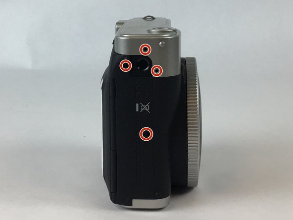

    • Face the front side of the camera towards you. To locate the left side turn the left side of the camera towards you.
    • Take out the four screws, sized 4.75 mm, with the Phillips #000 screwdriver.

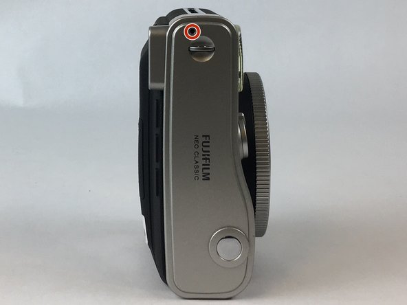

    • Looking at the left side, flip the top of the camera towards you to locate the top side of the camera.
    • Take out the screw, sized 9.75 mm, located on the top side, with a Phillips #000 screwdriver.

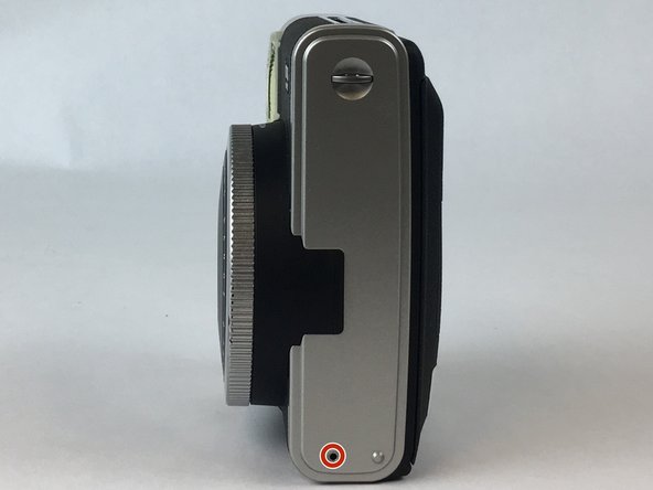

    • Looking at the top of the camera, flip the camera 180 degrees to locate the bottom side of the camera.
    • Take out the screw, sized 3.75 mm, located on the bottom side, this time with a Phillips #00 screwdriver.

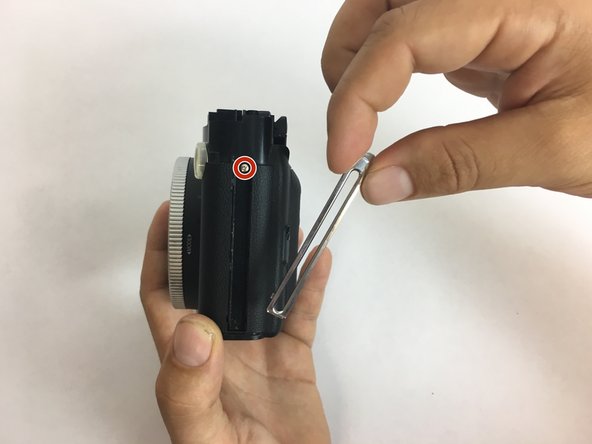

  6. Instax Mini 90 Photo Flash Capacitor Replacement: crwdns2935265:06crwdnd2935265:01crwdnd2935265:03crwdne2935265:0 Instax Mini 90 Photo Flash Capacitor Replacement: crwdns2935265:06crwdnd2935265:02crwdnd2935265:03crwdne2935265:0 Instax Mini 90 Photo Flash Capacitor Replacement: crwdns2935265:06crwdnd2935265:03crwdnd2935265:03crwdne2935265:0
    • Remove the anchors that hold the strap to the body of the camera. There is one on top, and one on the bottom.
    • Use the black spudger to pry off the silver casing on the top and the bottom of the camera.
    • Remove the metal piece from which the film is ejected located on the right side of the camera. There is a 4.75 mm screw under the metal piece. Use a Phillips #000 screw driver to remove it.
