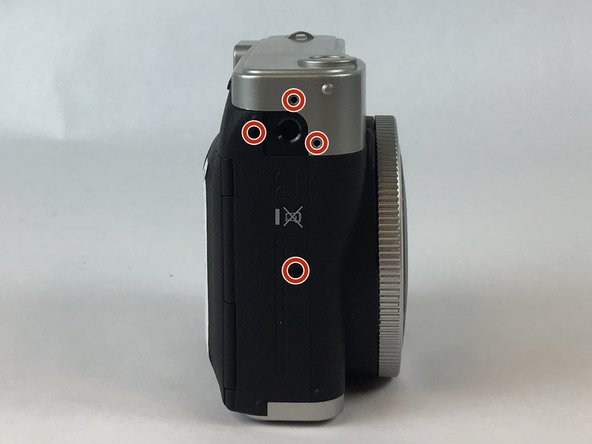

  3. Instax Mini 90 Lens Unit Replacement, Lens Unit: crwdns2935265:03crwdnd2935265:01crwdnd2935265:02crwdne2935265:0 Instax Mini 90 Lens Unit Replacement, Lens Unit: crwdns2935265:03crwdnd2935265:02crwdnd2935265:02crwdne2935265:0
    • Face the front side of the camera towards you. To locate the left side turn the left side of the camera towards you.
    • Take out the four screws, sized 4.75 mm, with the Phillips #000 screwdriver.
  4. Instax Mini 90 Lens Unit Replacement: crwdns2935265:04crwdnd2935265:01crwdnd2935265:02crwdne2935265:0 Instax Mini 90 Lens Unit Replacement: crwdns2935265:04crwdnd2935265:02crwdnd2935265:02crwdne2935265:0
    • Looking at the left side, flip the top of the camera towards you to locate the top side of the camera.
    • Take out the screw sized 9.75 mm, located on top side of the camera, with a Phillips #000 screwdriver.

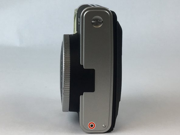

  5. Instax Mini 90 Lens Unit Replacement: crwdns2935265:05crwdnd2935265:01crwdnd2935265:02crwdne2935265:0 Instax Mini 90 Lens Unit Replacement: crwdns2935265:05crwdnd2935265:02crwdnd2935265:02crwdne2935265:0
    • Looking at the top of the camera, flip the camera 180 degrees to locate the bottom side of the camera.
    • Take out the screw, sized 3.75 mm, located on the bottom side of the camera, this time with a Phillips #00 screwdriver.

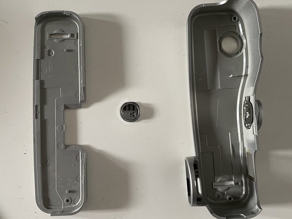

  6. Instax Mini 90 Lens Unit Replacement: crwdns2935265:06crwdnd2935265:01crwdnd2935265:03crwdne2935265:0 Instax Mini 90 Lens Unit Replacement: crwdns2935265:06crwdnd2935265:02crwdnd2935265:03crwdne2935265:0 Instax Mini 90 Lens Unit Replacement: crwdns2935265:06crwdnd2935265:03crwdnd2935265:03crwdne2935265:0
    • Remove the silver casing from the top of the camera. It is loosely clipped in and should come off easily.
    • Using a thin spudger, remove the chrome plastic cover from which the film is ejected. It is clipped onto the main body of the camera, and should come off with a sharp pull.
    • Using a thin spudger, pry off the silver casing from the bottom of the camera.
    • The bottom silver casing is clipped on tightly around the film ejection area, but is not held on by any screws or glue. Make sure to unclip it fully (this may take some force) before removing it, to avoid breaking it.

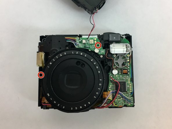

  9. Instax Mini 90 Lens Unit Replacement: crwdns2935265:09crwdnd2935265:01crwdnd2935265:03crwdne2935265:0 Instax Mini 90 Lens Unit Replacement: crwdns2935265:09crwdnd2935265:02crwdnd2935265:03crwdne2935265:0 Instax Mini 90 Lens Unit Replacement: crwdns2935265:09crwdnd2935265:03crwdnd2935265:03crwdne2935265:0
    • Set aside the black, plastic loop located inside the lens cavity.
    • Use a Phillips #000 screwdriver to remove the two 3.75 mm sized screws marked in the photo.
    • Move aside the motherboard located under the top screw. Then remove the marked 3.75 mm sized screw.
