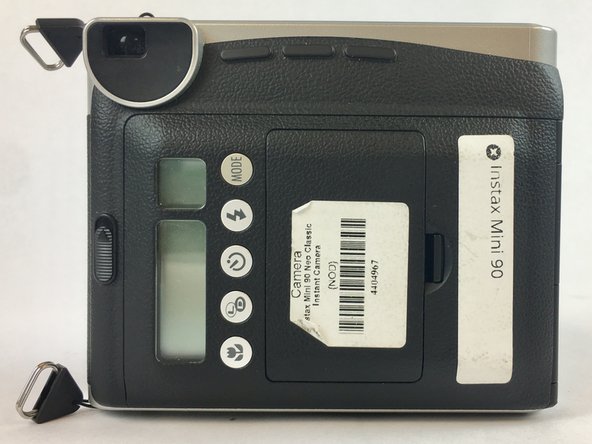

    • The battery compartment can be found on the backside of the camera. Pinpoint this compartment and focus on the right edge of the compartment gate to find the opening latch.
  2. Instax Mini 90 Battery Replacement: crwdns2935265:02crwdnd2935265:01crwdnd2935265:02crwdne2935265:0 Instax Mini 90 Battery Replacement: crwdns2935265:02crwdnd2935265:02crwdnd2935265:02crwdne2935265:0
    • Pinch the latch in towards the battery compartment gate. This will release the gate and allow it to open.
    • Completely open the gate and remove from camera for ease of insertion of the battery.
  3. Instax Mini 90 Battery Replacement: crwdns2935265:03crwdnd2935265:01crwdnd2935265:02crwdne2935265:0 Instax Mini 90 Battery Replacement: crwdns2935265:03crwdnd2935265:02crwdnd2935265:02crwdne2935265:0
    • Insert the battery into the battery compartment by following the diagram printed on the camera.
    • Be sure to connect the correct terminals of the battery to the camera.
    • Reattach battery compartment door to the camera and close firmly. A clicking sound will result when compartment door has been closed fully.
