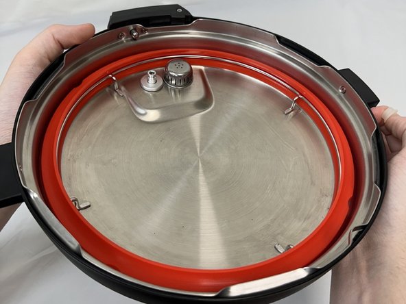

    • Remove the lid from the InstantPot.
    • Examine the piece for any damage unrelated to the rubber ring.

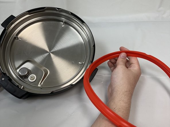

  2. Instant Pot 60 EPC Sealing Ring Replacement: crwdns2935265:02crwdnd2935265:01crwdnd2935265:03crwdne2935265:0 Instant Pot 60 EPC Sealing Ring Replacement: crwdns2935265:02crwdnd2935265:02crwdnd2935265:03crwdne2935265:0 Instant Pot 60 EPC Sealing Ring Replacement: crwdns2935265:02crwdnd2935265:03crwdnd2935265:03crwdne2935265:0
    • Press into one of the four divots around the edge of the sealing ring.
    • Pinch the rubber sealing ring between two fingers.
    • Gently remove the seal until it's completely separated from the lid.

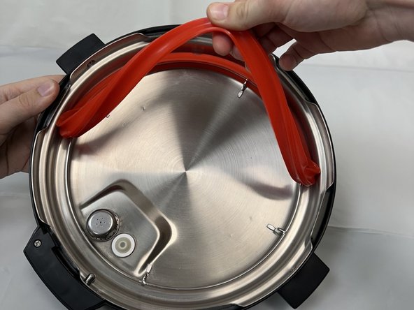

  3. Instant Pot 60 EPC Sealing Ring Replacement: crwdns2935265:03crwdnd2935265:01crwdnd2935265:02crwdne2935265:0 Instant Pot 60 EPC Sealing Ring Replacement: crwdns2935265:03crwdnd2935265:02crwdnd2935265:02crwdne2935265:0

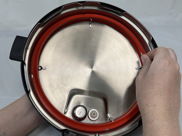

    • Insert the replacement ring.
    • Ensure the seal is completely inserterd into the grove on all sides.
After replacing the sealing ring, attach the lid back onto the Instant Pot.
