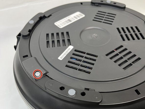

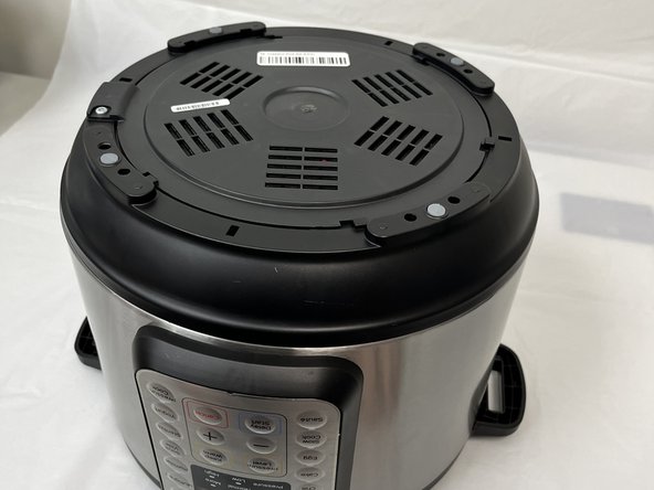

    • Ensure the device is unplugged and cool before beginning.
    • Remove the lid and inner pot from the Instant Pot and turn the body upside down.
    • Remove the single Torx screw.
  2. Instant Pot 60 EPC Pressure Sensor Replacement: crwdns2935265:02crwdnd2935265:01crwdnd2935265:02crwdne2935265:0 Instant Pot 60 EPC Pressure Sensor Replacement: crwdns2935265:02crwdnd2935265:02crwdnd2935265:02crwdne2935265:0
    • Turn the bottom face counterclockwise and remove it.

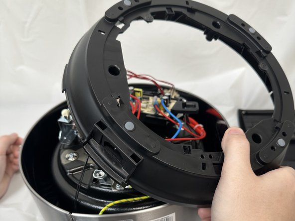

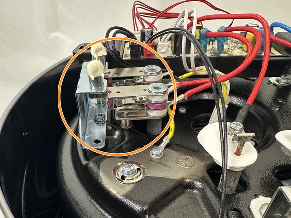

    • In order to reach the pressure sensor you'll need to remove the secondary frame.
    • Remove the three Phillips screws securing the frame.
    • Lift the frame, twist and set next to the body. Take care not to damage any of the attached wiring.

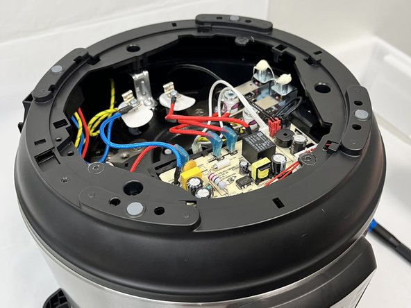

    • Locate the sensor. It has been highlighted in the final image.
  4. Instant Pot 60 EPC Pressure Sensor Replacement: crwdns2935265:04crwdnd2935265:01crwdnd2935265:02crwdne2935265:0 Instant Pot 60 EPC Pressure Sensor Replacement: crwdns2935265:04crwdnd2935265:02crwdnd2935265:02crwdne2935265:0

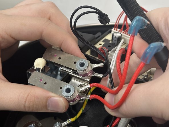

    • To remove the sensor, unscrew the main screw between the sensor and slide out.
  5. Instant Pot 60 EPC Pressure Sensor Replacement: crwdns2935265:05crwdnd2935265:01crwdnd2935265:03crwdne2935265:0 Instant Pot 60 EPC Pressure Sensor Replacement: crwdns2935265:05crwdnd2935265:02crwdnd2935265:03crwdne2935265:0 Instant Pot 60 EPC Pressure Sensor Replacement: crwdns2935265:05crwdnd2935265:03crwdnd2935265:03crwdne2935265:0

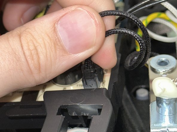

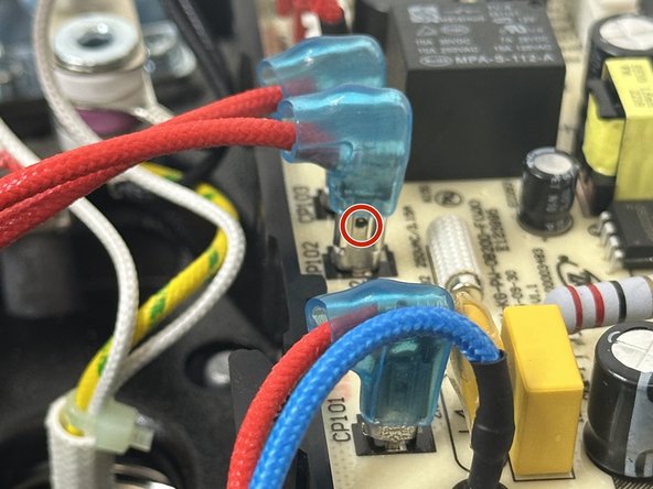

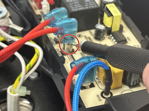

    • To remove the leads connecting the sensor to the motherboard you will need to unclip them.
    • In order to do so, slide the blue covering up to expose the small hole in the lead.
    • Place a SIM card punch into the hole to unsecure the leads and pull them up. If a SIM card punch is not avaliable then a paperclip or earring should suffice.
  6. Instant Pot 60 EPC Pressure Sensor Replacement: crwdns2935265:06crwdnd2935265:01crwdnd2935265:02crwdne2935265:0 Instant Pot 60 EPC Pressure Sensor Replacement: crwdns2935265:06crwdnd2935265:02crwdnd2935265:02crwdne2935265:0
    • There will be a secondary lead that is black connecting the sensor the the motherboard.
    • In order to remove that lead just squeeze and pull up.
