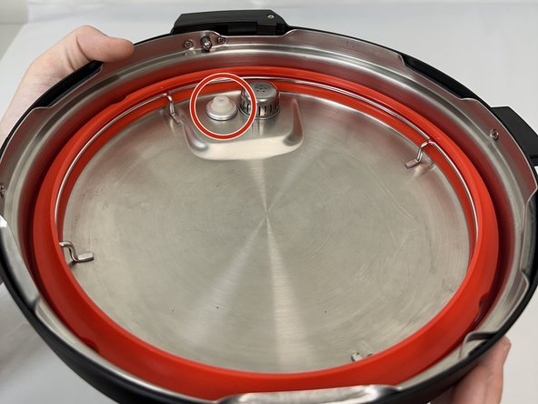

    • Remove the lid from the Instant Pot and turn it around to see the inside.
    • Locate the float valve.

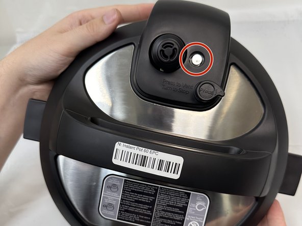

  2. Instant Pot 60 EPC Float Valve Replacement: crwdns2935265:02crwdnd2935265:01crwdnd2935265:03crwdne2935265:0 Instant Pot 60 EPC Float Valve Replacement: crwdns2935265:02crwdnd2935265:02crwdnd2935265:03crwdne2935265:0 Instant Pot 60 EPC Float Valve Replacement: crwdns2935265:02crwdnd2935265:03crwdnd2935265:03crwdne2935265:0
    • Remove the plastic covering on the float valve.

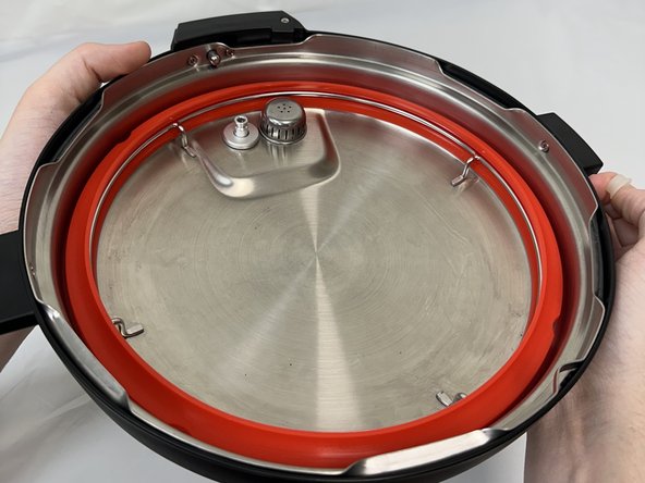

  3. Instant Pot 60 EPC Float Valve Replacement: crwdns2935265:03crwdnd2935265:01crwdnd2935265:01crwdne2935265:0
    • Flip the lid over and remove the valve from the top of the lid.

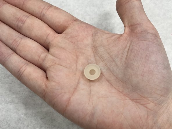

    • The float valve is now free and can be replaced with a new one.
    • Instant Pot does not supply replacement valves so one will need to be purchased from a secondary source.
