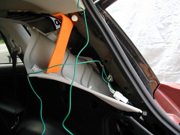

  10. Installing a Tow Hitch on a 2013 RAV4: crwdns2935265:012crwdnd2935265:01crwdnd2935265:02crwdne2935265:0 Installing a Tow Hitch on a 2013 RAV4: crwdns2935265:012crwdnd2935265:02crwdnd2935265:02crwdne2935265:0
    • The green wire to the passenger side harness can be run under the top panel which can be pried open slightly along the rubber seal. Run the wire down inside the side panel. Attach to T-connector to the wiring harness.

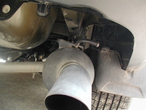

  14. Installing a Tow Hitch on a 2013 RAV4: crwdns2935265:019crwdnd2935265:01crwdnd2935265:02crwdne2935265:0 Installing a Tow Hitch on a 2013 RAV4: crwdns2935265:019crwdnd2935265:02crwdnd2935265:02crwdne2935265:0
    • With wiring complete, installing the hitch first required removing the muffler from the rear exhaust isolator, a rubber bracket holding the metal peg attached to the muffler. Some people find this step unnecessary, but working alone, doing this made the installation easier.
  15. Installing a Tow Hitch on a 2013 RAV4: crwdns2935265:020crwdnd2935265:01crwdnd2935265:01crwdne2935265:0
    • The driver's side has a hidden hitch bracket which needs to be unbolted from the frame before the hitch can be attached. One of those holes will be used and another uncovered to attach that side of the hitch.
    • There is a metal 'Y' bolted to the top of the muffler that prevents it from swaying into the gas tank. If after installing the hitch, you hear it rattling against the hitch, try removing the two hex bolts and reversing it.
    • With the muffler free, it was easier to access the passenger side frame where pre-drilled holes existed. They are covered by a thin piece of material which can be scrapped off. I applied some grease to the hitch bolts before inserting and torquing them to 86 foot pounds.
