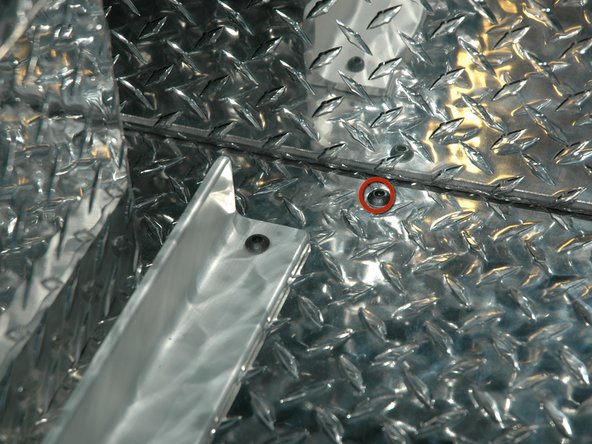

    • Remove bolt from rear deck sill plate
    • Unclip rear deck sill plate and remove.

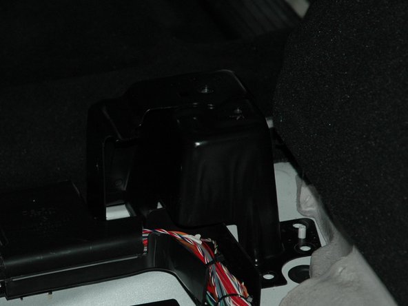

    • Remove side consoles and center support (T30 10 Bolts)
  5. Installing Mercedes W166 RAV Tool Box: crwdns2935265:05crwdnd2935265:01crwdnd2935265:03crwdne2935265:0 Installing Mercedes W166 RAV Tool Box: crwdns2935265:05crwdnd2935265:02crwdnd2935265:03crwdne2935265:0 Installing Mercedes W166 RAV Tool Box: crwdns2935265:05crwdnd2935265:03crwdnd2935265:03crwdne2935265:0

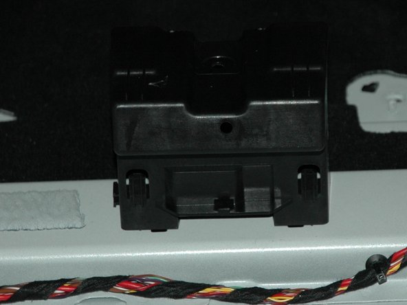

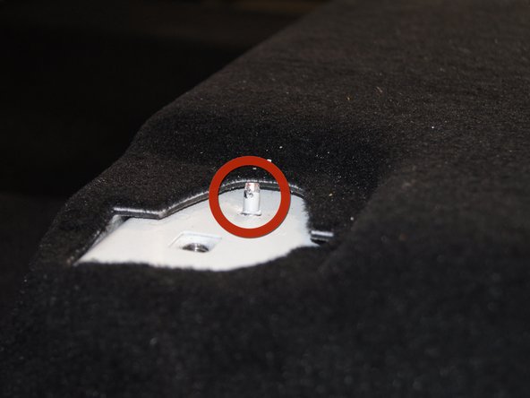

    • Install and bolt down center support bracket (2 Bolts M10 x 1.5 x35mm 6mm Allen cap, 10mm flat washers)
    • Pay attention to the pin to align properly

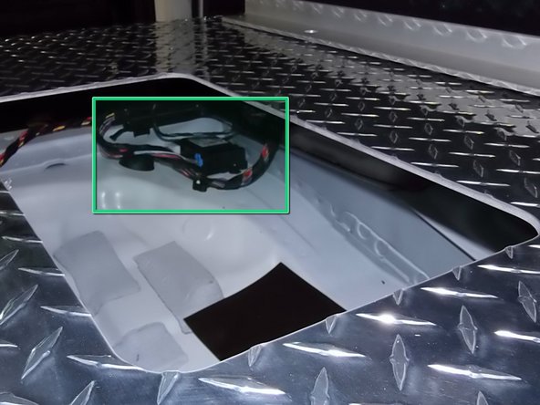

    • NOTE: To service TPMS control module remove drawers ad service through access door in bottom plate.

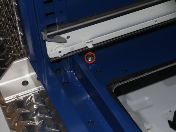

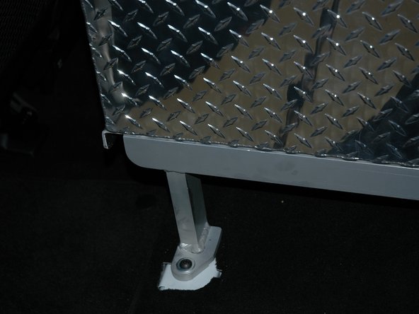

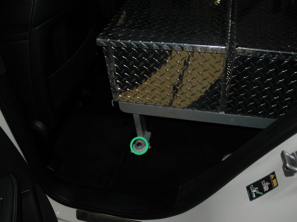

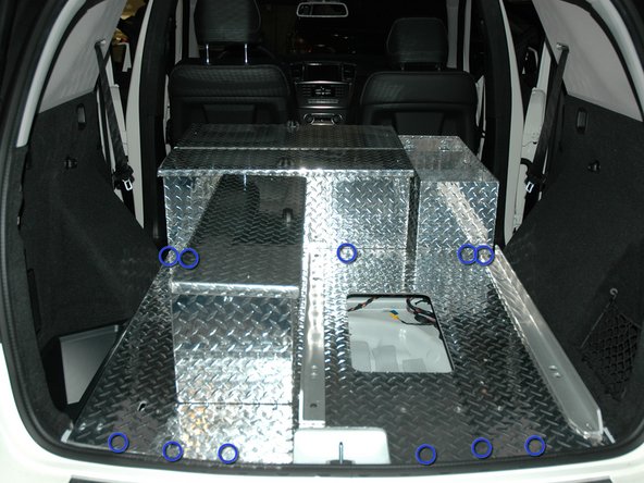

    • 2. Installation of Front Box
    • Place box inside vehicle. It fits through the rear doors. This is a 2 person job.

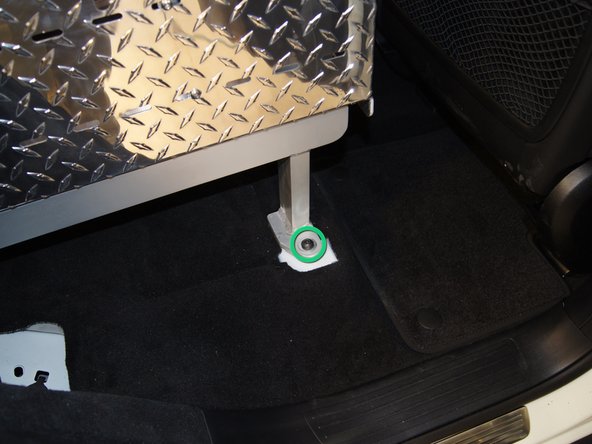

    • Mount front legs on front consoles, tighten loosely (2 Bolts M10 x 1.5 x35mm 6mm Allen cap, 10mm flat washers). Pay attention not to break off the alignment pin, which will be inside the post after mounting.
    • DO NOT mount the box to the center bracket at this point

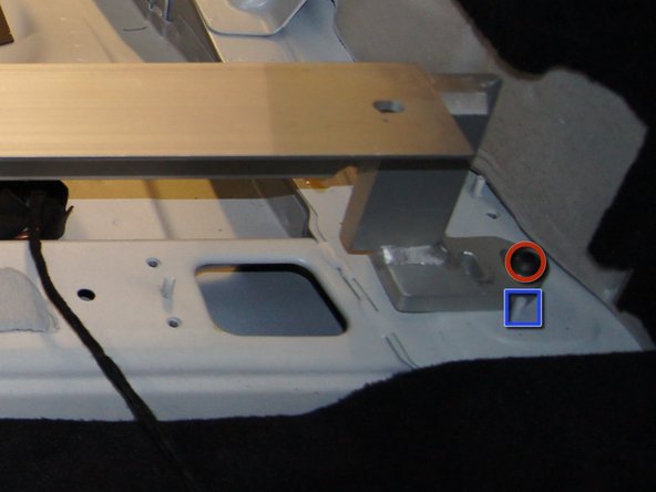

    • 3. Installation of the rear plate
    • Install 6 rear support brackets and tighten finger tight
  8. Installing Mercedes W166 RAV Tool Box: crwdns2935265:08crwdnd2935265:01crwdnd2935265:03crwdne2935265:0 Installing Mercedes W166 RAV Tool Box: crwdns2935265:08crwdnd2935265:02crwdnd2935265:03crwdne2935265:0 Installing Mercedes W166 RAV Tool Box: crwdns2935265:08crwdnd2935265:03crwdnd2935265:03crwdne2935265:0

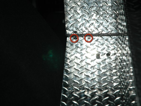

    • Set plate on brackets and align, overlapping the base plate of the front box on the center support bracket.
    • Use punch tool to align holes and drop in 2 bolts M8 x 1.25 x 40mm in holes on each side and one bolt M8 x 1.25 x 30 in the center hole.
  9. Installing Mercedes W166 RAV Tool Box: crwdns2935265:09crwdnd2935265:01crwdnd2935265:03crwdne2935265:0 Installing Mercedes W166 RAV Tool Box: crwdns2935265:09crwdnd2935265:02crwdnd2935265:03crwdne2935265:0 Installing Mercedes W166 RAV Tool Box: crwdns2935265:09crwdnd2935265:03crwdnd2935265:03crwdne2935265:0
    • Secure plate to center support bracket with 2 bolts on the outside and on in the middle, align and finger tighten

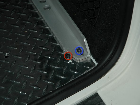

  10. Installing Mercedes W166 RAV Tool Box: crwdns2935265:010crwdnd2935265:01crwdnd2935265:02crwdne2935265:0 Installing Mercedes W166 RAV Tool Box: crwdns2935265:010crwdnd2935265:02crwdnd2935265:02crwdne2935265:0
    • Install 3 bolts securing base plate to vehicle frame
    • and 4th bolt securing the tool box rail to the base plate and vehicle frame.
    • Put bolt sizes in

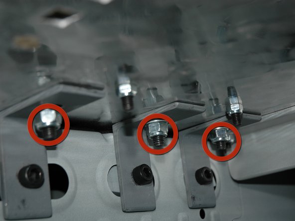

  11. Installing Mercedes W166 RAV Tool Box: crwdns2935265:011crwdnd2935265:01crwdnd2935265:02crwdne2935265:0 Installing Mercedes W166 RAV Tool Box: crwdns2935265:011crwdnd2935265:02crwdnd2935265:02crwdne2935265:0

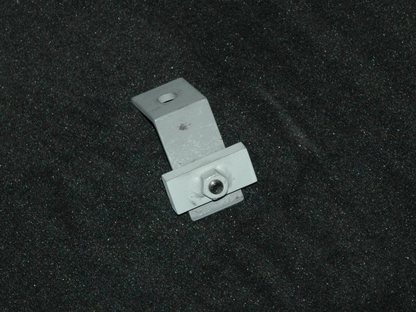

    • Install and loosely tighten 3 M8 black oxide bolts on each side until L bracket touches the underside of the base plate
  12. Installing Mercedes W166 RAV Tool Box: crwdns2935265:012crwdnd2935265:01crwdnd2935265:02crwdne2935265:0 Installing Mercedes W166 RAV Tool Box: crwdns2935265:012crwdnd2935265:02crwdnd2935265:02crwdne2935265:0
    • Fully tighten M8 (20 Nm)
    • Fully tighten M6 (8 Nm)

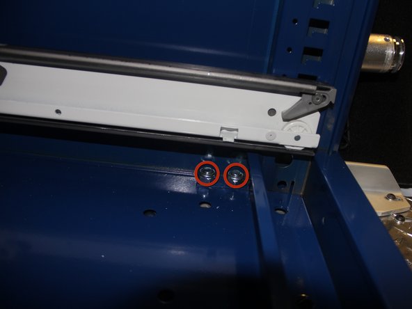

    • 4. Install box
    • Remove drawers and slide box on rail guides, align with bolt holes
    • Install 6 (M12) bolts and fully tighten to 66 Nm

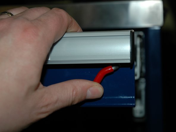

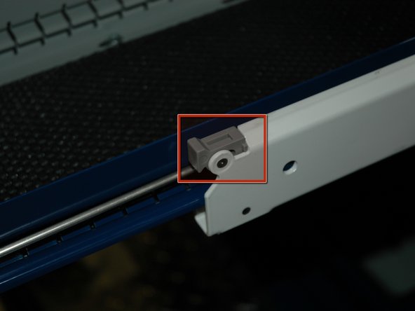

  15. Installing Mercedes W166 RAV Tool Box: crwdns2935265:015crwdnd2935265:01crwdnd2935265:03crwdne2935265:0 Installing Mercedes W166 RAV Tool Box: crwdns2935265:015crwdnd2935265:02crwdnd2935265:03crwdne2935265:0 Installing Mercedes W166 RAV Tool Box: crwdns2935265:015crwdnd2935265:03crwdnd2935265:03crwdne2935265:0
    • Install drawers.
    • After drawer is installed move rail clip to locked position
