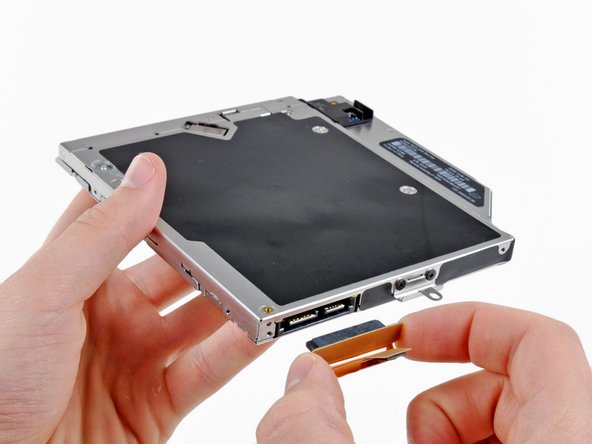

    1. Installing MacBook Pro 17" Unibody Dual Drive, Optical Drive: crwdns2935265:013crwdnd2935265:01crwdnd2935265:03crwdne2935265:0 Installing MacBook Pro 17" Unibody Dual Drive, Optical Drive: crwdns2935265:013crwdnd2935265:02crwdnd2935265:03crwdne2935265:0 Installing MacBook Pro 17" Unibody Dual Drive, Optical Drive: crwdns2935265:013crwdnd2935265:03crwdnd2935265:03crwdne2935265:0
      • Grab the optical drive cable by its connector and pull it away from the body of the hard drive.
      • Pulling on anything but the connector may damage the optical drive cable.

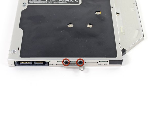

      • Remove the two black Phillips #0 screws securing the small metal mounting bracket. Transfer this bracket to your new optical drive or hard drive enclosure.

    5. Installing MacBook Pro 17" Unibody Dual Drive: crwdns2935265:020crwdnd2935265:01crwdnd2935265:01crwdne2935265:0
      • Attach the optical drive bracket to the new enclosure with two Phillips #0 screws.
      • Reconnect any cables you have removed from the original optical drive onto the optical bay enclosure.
