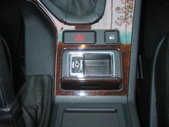

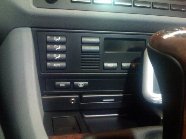

    • Mount Auxillary Audio input headphone jack in your preferred location. BMW recommends the Glovebox. You may mount wherever desired
    • Reinstall Navigation display and you may now use the MODE button to select Aux as your audio source.
  4. Installing BMW OEM Aux cable in 2003 BMW 5 Series: crwdns2935265:04crwdnd2935265:01crwdnd2935265:01crwdne2935265:0
    • Once installed connect your audio device to the Aux Audio Input plug and use the MODE button to select AUX on your radio display
