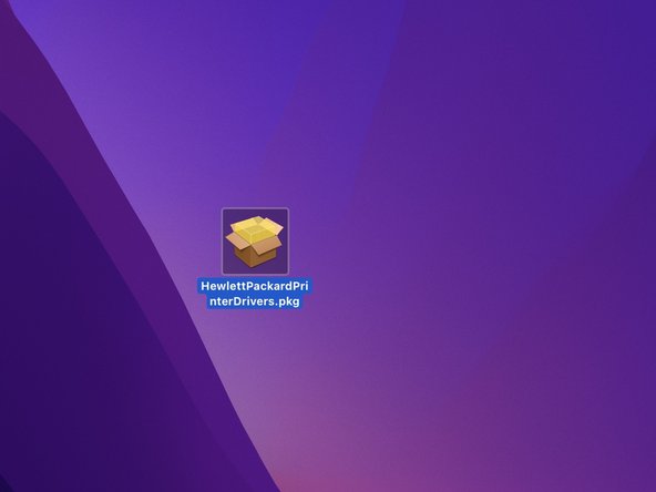

Fix the problem "This update requires macOS 12.0 or earlier." Or install printer drivers on macOS. (Pilots, Drivers)
    1. Install macOS Printer Drivers, Install macOS Printer Drivers: crwdns2935265:01crwdnd2935265:01crwdnd2935265:02crwdne2935265:0 Install macOS Printer Drivers, Install macOS Printer Drivers: crwdns2935265:01crwdnd2935265:02crwdnd2935265:02crwdne2935265:0
      • Find the driver for your printer brand on the link below:
      • https://support.apple.com/kb/index?page=...
      • Download the driver for your printer, by clicking on the "Download" button.
      • If the message: "This connection is not private" appears, open the page with the private mode of your browser.
    2. Install macOS Printer Drivers: crwdns2935265:02crwdnd2935265:01crwdnd2935265:02crwdne2935265:0 Install macOS Printer Drivers: crwdns2935265:02crwdnd2935265:02crwdnd2935265:02crwdne2935265:0
      • Open your .dmg file
      • Open your .pkg file
      • If this message appears: "This update requires macOS 12.0 or earlier." click Close and continue with the next step.
      • Otherwise, continue with step 7.
    3. Install macOS Printer Drivers: crwdns2935265:03crwdnd2935265:01crwdnd2935265:03crwdne2935265:0 Install macOS Printer Drivers: crwdns2935265:03crwdnd2935265:02crwdnd2935265:03crwdne2935265:0 Install macOS Printer Drivers: crwdns2935265:03crwdnd2935265:03crwdnd2935265:03crwdne2935265:0
      • Move your .pkg file to your desktop
      • Open Terminal
      • Enter: cd Desktop/ then press the Enter key
    4. Install macOS Printer Drivers: crwdns2935265:04crwdnd2935265:01crwdnd2935265:03crwdne2935265:0 Install macOS Printer Drivers: crwdns2935265:04crwdnd2935265:02crwdnd2935265:03crwdne2935265:0 Install macOS Printer Drivers: crwdns2935265:04crwdnd2935265:03crwdnd2935265:03crwdne2935265:0
      • Enter the following command: pkgutil --expand FileName.pkg FileName
      • Change FileName to the name of your file, in both places.
      • Then press the Enter key.
      • A folder with the file name appears on your desktop.
      • Open the folder.
    5. Install macOS Printer Drivers: crwdns2935265:05crwdnd2935265:01crwdnd2935265:02crwdne2935265:0 Install macOS Printer Drivers: crwdns2935265:05crwdnd2935265:02crwdnd2935265:02crwdne2935265:0
      • Open the Distribution file with TextEdit
      • Then change the number after (system.compareVersions(system.version.ProductVersion, '12.0')" to that of your macOS version or later.
      • Save the file and close it.
    6. Install macOS Printer Drivers: crwdns2935265:06crwdnd2935265:01crwdnd2935265:02crwdne2935265:0 Install macOS Printer Drivers: crwdns2935265:06crwdnd2935265:02crwdnd2935265:02crwdne2935265:0
      • Return to the Terminal
      • Enter the following command: pkgutil --flatten FileName FileName.pkg and press the Enter key.
      • Close theTerminal and open FileName.pkg on your desktop.
    7. Install macOS Printer Drivers: crwdns2935265:07crwdnd2935265:01crwdnd2935265:01crwdne2935265:0
      • Congratulations, you can proceed with the installation by following the steps one by one.
