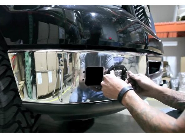

    • First, tape over the area you want your new LED pod lights to sit and get the outer brackets and draw where you need to cut.
  2. Install LED Pod Lights on a Off-Road Truck Jeep: crwdns2935265:02crwdnd2935265:01crwdnd2935265:03crwdne2935265:0 Install LED Pod Lights on a Off-Road Truck Jeep: crwdns2935265:02crwdnd2935265:02crwdnd2935265:03crwdne2935265:0 Install LED Pod Lights on a Off-Road Truck Jeep: crwdns2935265:02crwdnd2935265:03crwdnd2935265:03crwdne2935265:0
    • Now cut out the hole with an angle grinder.
    • Then, take a drill and cut the holes for the LED pod lights to screw on.
  3. Install LED Pod Lights on a Off-Road Truck Jeep: crwdns2935265:03crwdnd2935265:01crwdnd2935265:03crwdne2935265:0 Install LED Pod Lights on a Off-Road Truck Jeep: crwdns2935265:03crwdnd2935265:02crwdnd2935265:03crwdne2935265:0 Install LED Pod Lights on a Off-Road Truck Jeep: crwdns2935265:03crwdnd2935265:03crwdnd2935265:03crwdne2935265:0
    • Insert in your new LED Pod Lights and screw it in tightly to your truck.
    • For wiring, it depends on what you want the functionality to be.
    • For example, for reverse lights, tap the wires to existing reverse lamp positive and negative.
This LED pod light kit for truck installation is straight forward and will transform your vehicle into a one of a kind machine. Not only is it super bright but also looks great!
