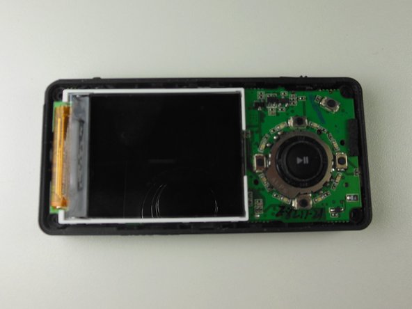

  8. Insignia Sport NS-4V17 Scroll Wheel Replacement: crwdns2935265:08crwdnd2935265:01crwdnd2935265:01crwdne2935265:0
    • Once the front cover is loose, use your fingers to remove the front case cover for a new installation.
  9. Insignia Sport NS-4V17 Scroll Wheel Replacement, Scroll Wheel: crwdns2935265:09crwdnd2935265:01crwdnd2935265:01crwdne2935265:0
    • Remove the white plastic ring from around the scroll wheel using your fingers.

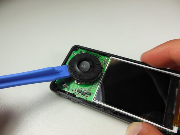

  10. Insignia Sport NS-4V17 Scroll Wheel Replacement: crwdns2935265:010crwdnd2935265:01crwdnd2935265:03crwdne2935265:0 Insignia Sport NS-4V17 Scroll Wheel Replacement: crwdns2935265:010crwdnd2935265:02crwdnd2935265:03crwdne2935265:0 Insignia Sport NS-4V17 Scroll Wheel Replacement: crwdns2935265:010crwdnd2935265:03crwdnd2935265:03crwdne2935265:0
    • Insert the plastic opening tool underneath any side of the scroll wheel.
    • Slowly lift up on the plastic opening tool and the scroll wheel will come off.
