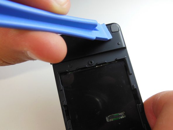

  5. Insignia Sport NS-4V17 Motherboard Replacement, Front Case Cover: crwdns2935265:05crwdnd2935265:01crwdnd2935265:02crwdne2935265:0 Insignia Sport NS-4V17 Motherboard Replacement, Front Case Cover: crwdns2935265:05crwdnd2935265:02crwdnd2935265:02crwdne2935265:0
    • Remove the four corner plastic covers on the back of the device using the plastic opening tool.

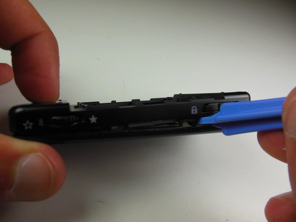

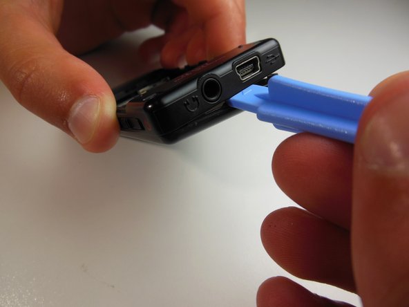

  7. Insignia Sport NS-4V17 Motherboard Replacement: crwdns2935265:07crwdnd2935265:01crwdnd2935265:03crwdne2935265:0 Insignia Sport NS-4V17 Motherboard Replacement: crwdns2935265:07crwdnd2935265:02crwdnd2935265:03crwdne2935265:0 Insignia Sport NS-4V17 Motherboard Replacement: crwdns2935265:07crwdnd2935265:03crwdnd2935265:03crwdne2935265:0
    • Carefully wedge the plastic opening tool into either long side of the device.
    • Slowly move the plastic opening tool along the side of the device, separating the front and back case covers.
    • Repeat these steps on the other side of the device.
  8. Insignia Sport NS-4V17 Motherboard Replacement: crwdns2935265:08crwdnd2935265:01crwdnd2935265:01crwdne2935265:0
    • Once the front cover is loose, use your fingers to remove the front case cover for a new installation.

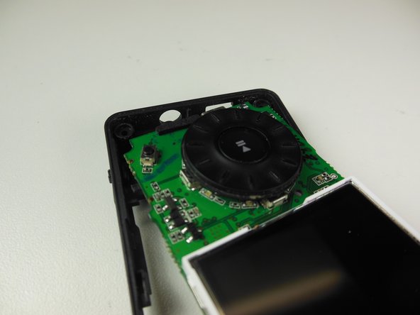

  9. Insignia Sport NS-4V17 Motherboard Replacement, Motherboard: crwdns2935265:09crwdnd2935265:01crwdnd2935265:01crwdne2935265:0
    • Remove the white plastic ring from around the scroll wheel with your fingers.
  10. Insignia Sport NS-4V17 Motherboard Replacement: crwdns2935265:010crwdnd2935265:01crwdnd2935265:01crwdne2935265:0
    • Hold the sides of the device firmly with one hand.
    • Push down on the black favorite switch with your other hand so that it is pushed into the case.
  11. Insignia Sport NS-4V17 Motherboard Replacement: crwdns2935265:011crwdnd2935265:01crwdnd2935265:02crwdne2935265:0 Insignia Sport NS-4V17 Motherboard Replacement: crwdns2935265:011crwdnd2935265:02crwdnd2935265:02crwdne2935265:0
    • With the component pushed in, lift up the top of the motherboard from the case.
    • Pull the motherboard from the top so that the audio jack and usb input are removed from the case socket.
