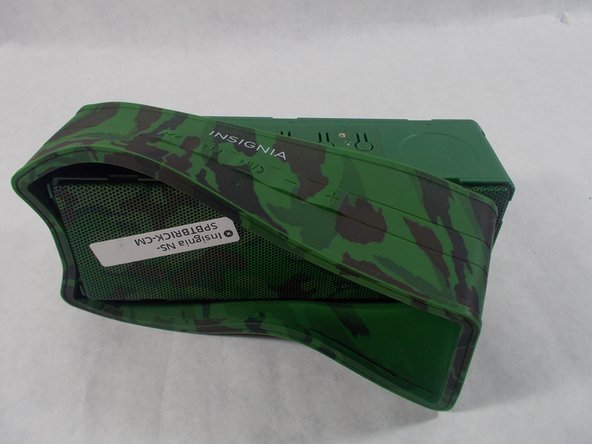

    • Remove the rubber sleeve.

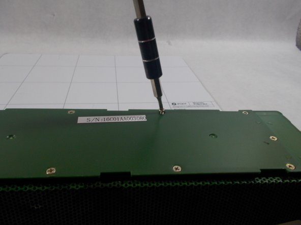

  2. Insignia NS-SPBTBRICK-CM USB Port Replacement: crwdns2935265:02crwdnd2935265:01crwdnd2935265:01crwdne2935265:0
    • Use the specified screwdriver to unscrew the ten screws on the back cover.
  3. Insignia NS-SPBTBRICK-CM USB Port Replacement: crwdns2935265:03crwdnd2935265:01crwdnd2935265:02crwdne2935265:0 Insignia NS-SPBTBRICK-CM USB Port Replacement: crwdns2935265:03crwdnd2935265:02crwdnd2935265:02crwdne2935265:0
    • Remove the back cover. Be careful to not lose any of the screws because they are extremely small and can be easily lost.
