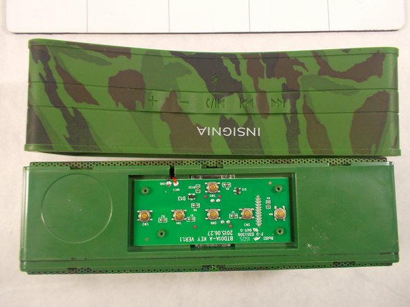

    • Remove the rubber sleeve.

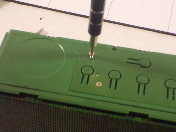

    • Remove 4 screws from the green, plastic button cover.

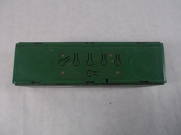

    • After successfully removing the plastic cover, use a sauter against the bluetooth button. The heat will make the removal of the button easy.
    • Place the new bluetooth button in the place of the old bluetooth button and mend the button into place using heat.
