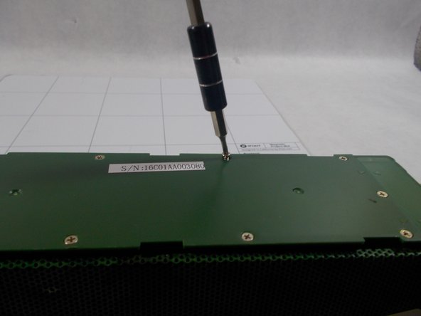

  2. Insignia NS-SPBTBRICK-CM Back Cover and Battery Replacement: crwdns2935265:02crwdnd2935265:01crwdnd2935265:02crwdne2935265:0 Insignia NS-SPBTBRICK-CM Back Cover and Battery Replacement: crwdns2935265:02crwdnd2935265:02crwdnd2935265:02crwdne2935265:0
    • Use the specified screwdriver to unscrew the ten screws on the back cover.
  3. Insignia NS-SPBTBRICK-CM Back Cover and Battery Replacement: crwdns2935265:03crwdnd2935265:01crwdnd2935265:02crwdne2935265:0 Insignia NS-SPBTBRICK-CM Back Cover and Battery Replacement: crwdns2935265:03crwdnd2935265:02crwdnd2935265:02crwdne2935265:0
    • Remove the back cover. Be careful to not lose any of the screws because they are extremely small and can be easily lost.

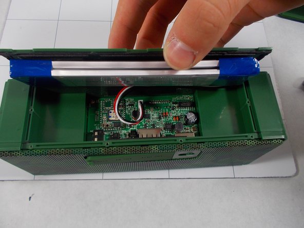

  4. Insignia NS-SPBTBRICK-CM Back Cover and Battery Replacement: crwdns2935265:04crwdnd2935265:01crwdnd2935265:02crwdne2935265:0 Insignia NS-SPBTBRICK-CM Back Cover and Battery Replacement: crwdns2935265:04crwdnd2935265:02crwdnd2935265:02crwdne2935265:0
    • The battery will be attached to the back cover with sticky tape. Unplug the wires connecting the battery to the speaker.
    • Using one of the four blue opening tools, pry the battery off of the back cover.
  5. Insignia NS-SPBTBRICK-CM Back Cover and Battery Replacement: crwdns2935265:06crwdnd2935265:01crwdnd2935265:01crwdne2935265:0
    • Stick the new battery to the back cover using sticky tape.

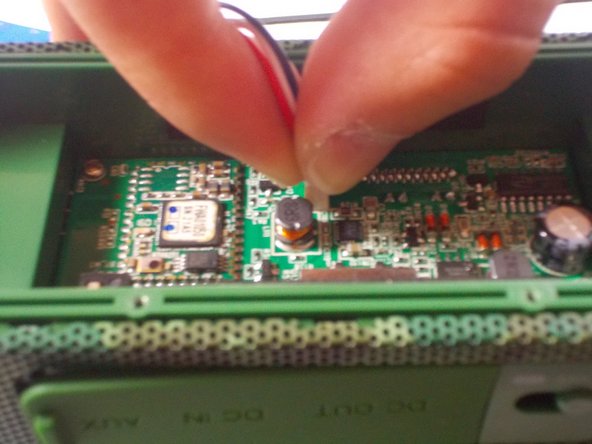

  6. Insignia NS-SPBTBRICK-CM Back Cover and Battery Replacement: crwdns2935265:07crwdnd2935265:01crwdnd2935265:01crwdne2935265:0
    • Connect the wire from the new battery to the bluetooth speaker.
  7. Insignia NS-SPBTBRICK-CM Back Cover and Battery Replacement: crwdns2935265:08crwdnd2935265:01crwdnd2935265:03crwdne2935265:0 Insignia NS-SPBTBRICK-CM Back Cover and Battery Replacement: crwdns2935265:08crwdnd2935265:02crwdnd2935265:03crwdne2935265:0 Insignia NS-SPBTBRICK-CM Back Cover and Battery Replacement: crwdns2935265:08crwdnd2935265:03crwdnd2935265:03crwdne2935265:0
    • Place cover back on and using the iFixit screwdriver PH000, screw the ten screws back onto the back cover.
