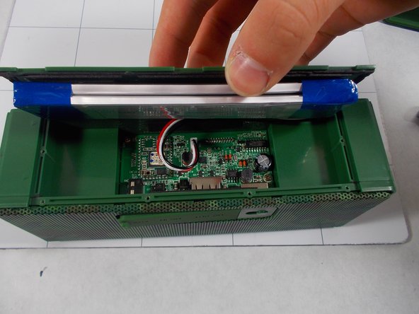

    • Remove the rubber sleeve.

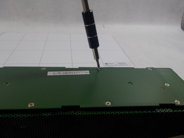

    • Use the specified screwdriver to unscrew the ten screws on the back cover.
  3. Insignia NS-SPBTBRICK-CM Auxiliary Port Replacement: crwdns2935265:03crwdnd2935265:01crwdnd2935265:02crwdne2935265:0 Insignia NS-SPBTBRICK-CM Auxiliary Port Replacement: crwdns2935265:03crwdnd2935265:02crwdnd2935265:02crwdne2935265:0

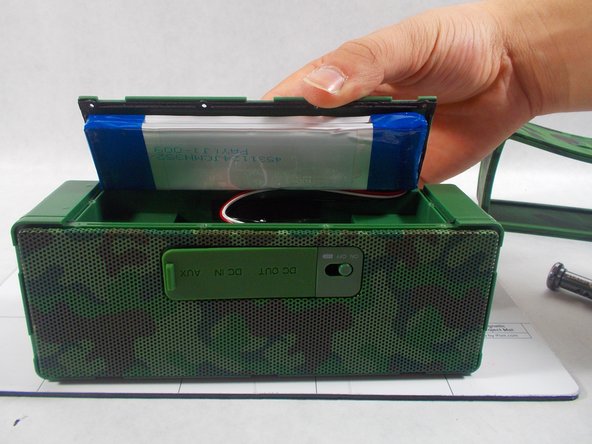

    • Remove the back cover. Be careful to not lose any of the screws because they are extremely small and can be easily lost.

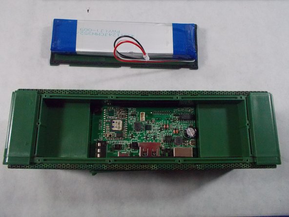

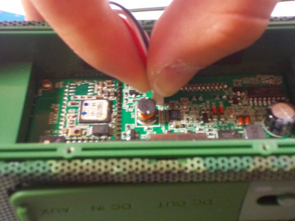

    • The battery will be attached to the back cover with sticky tape. Unplug the wires connecting the battery to the speaker.

    • Once the battery and back cover have been successfully removed, use the sauter by placing the soldering iron on one side of the auxiliary port button.
  6. crwdns2935267:0crwdne2935267:0
    • Once the metal is heated, use a pair of tweezers to grab the part and pull it off of the circuit board. Be careful not to alter the circuit board in any way with the heat. Also, be careful when removing the part because the metal will be very hot.
