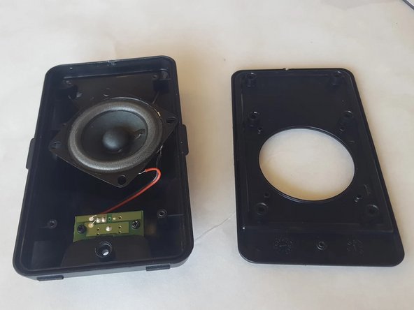

    • Now take the size J0 JIS screwdriver to remove the seven 5 mm screws on the plastic casing of the speaker.
    • Do not forget about the 5mm screw on the backside of the speaker, it may be covered by a white sticker, and it will prevent you from removing the plastic cover.
  4. Insignia NS-PLTPSP13 Circuit Board Replacement: crwdns2935265:04crwdnd2935265:01crwdnd2935265:02crwdne2935265:0 Insignia NS-PLTPSP13 Circuit Board Replacement: crwdns2935265:04crwdnd2935265:02crwdnd2935265:02crwdne2935265:0
    • Once all seven 5mm screws are taken off use the metal spudger again to pry off the plastic casing from the speaker.
  5. Insignia NS-PLTPSP13 Circuit Board Replacement: crwdns2935265:05crwdnd2935265:01crwdnd2935265:02crwdne2935265:0 Insignia NS-PLTPSP13 Circuit Board Replacement: crwdns2935265:05crwdnd2935265:02crwdnd2935265:02crwdne2935265:0

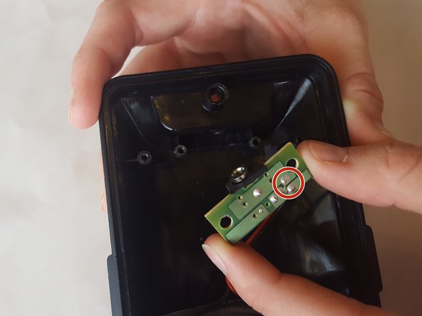

    • To further take apart the speaker, there are also two 5mm screws on the green circuit board which keep the speaker and circuit board attached. Unscrew these with the size J0 JIS screwdriver.
  6. Insignia NS-PLTPSP13 Circuit Board Replacement, Circuit Board: crwdns2935265:06crwdnd2935265:01crwdnd2935265:02crwdne2935265:0 Insignia NS-PLTPSP13 Circuit Board Replacement, Circuit Board: crwdns2935265:06crwdnd2935265:02crwdnd2935265:02crwdne2935265:0
