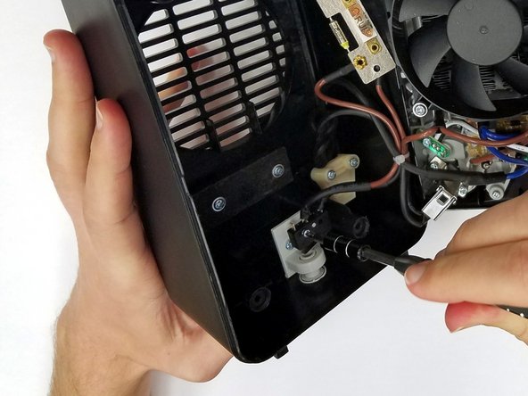

    • Flip the device over so the back panel faces up.
    • Unscrew the four screws counter-clockwise from the back panel using a 4mm Phillips screwdriver.
    • You may want to use a flashlight during this step, as the screws are hard to see.
    • Make sure to firmly connect your screwdriver with the head of the screw. A loose connection can strip the screw head, making the screws nearly impossible to remove.
  2. Insignia NS-HTMC01-B Tip-Over Safety Switch Replacement: crwdns2935265:02crwdnd2935265:01crwdnd2935265:01crwdne2935265:0
    • Take the screws out and set them aside.
    • Be sure to set them somewhere flat, so they don't roll away.
    • Gently pull the front panel and back panel apart to open the device.

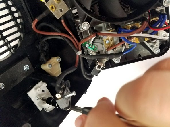

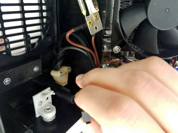

  3. Insignia NS-HTMC01-B Tip-Over Safety Switch Replacement, Tip-Over Safety Switch: crwdns2935265:03crwdnd2935265:01crwdnd2935265:03crwdne2935265:0 Insignia NS-HTMC01-B Tip-Over Safety Switch Replacement, Tip-Over Safety Switch: crwdns2935265:03crwdnd2935265:02crwdnd2935265:03crwdne2935265:0 Insignia NS-HTMC01-B Tip-Over Safety Switch Replacement, Tip-Over Safety Switch: crwdns2935265:03crwdnd2935265:03crwdnd2935265:03crwdne2935265:0
    • Use a Phillips #0 screwdriver to remove the 1.3mm screw on the black rectangle above the Tip-Over Safety Switch.

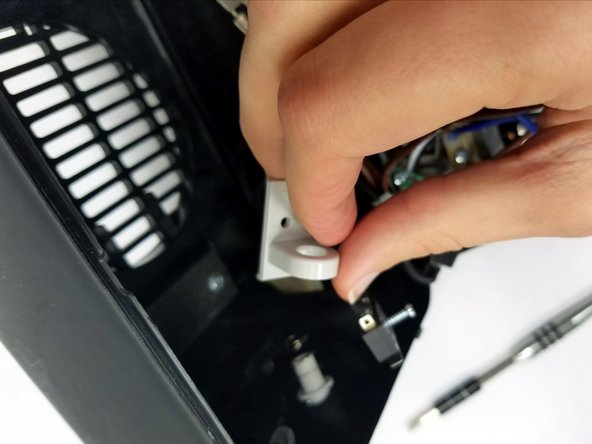

  4. Insignia NS-HTMC01-B Tip-Over Safety Switch Replacement: crwdns2935265:04crwdnd2935265:01crwdnd2935265:03crwdne2935265:0 Insignia NS-HTMC01-B Tip-Over Safety Switch Replacement: crwdns2935265:04crwdnd2935265:02crwdnd2935265:03crwdne2935265:0 Insignia NS-HTMC01-B Tip-Over Safety Switch Replacement: crwdns2935265:04crwdnd2935265:03crwdnd2935265:03crwdne2935265:0
    • Use a Phillips #2 screwdriver to remove the 0.9mm screw from the back panel of the Tip-Over Safety Switch.
    • Remove the back panel and the Tip-Over Safety Switch.
