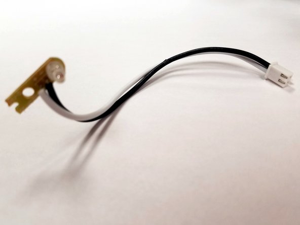

    • After unscrewing the black rectangular box up from the base of the grey frame, locate the small green rectangular light fixture.
    • Unscrew the one screw from the green rectangle counter clockwise, and set the screw to the side.
    • Gently lift the green circuit board out of the socket by pulling on the black and white cables.
    • At the end of the green rectangle is a light-emitting diode (LED). This is what lights up the power button.
  5. Insignia NS-HTMC01-B Power Indicator Light Replacement: crwdns2935265:05crwdnd2935265:01crwdnd2935265:02crwdne2935265:0 Insignia NS-HTMC01-B Power Indicator Light Replacement: crwdns2935265:05crwdnd2935265:02crwdnd2935265:02crwdne2935265:0
    • To replace the LED, unplug the white jack with the black and white cords from the bigger tan circuit board.
    • Remove the LED cord.
