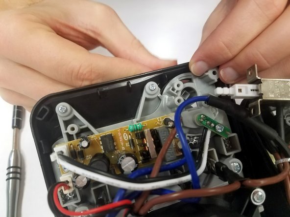

    • Flip your device over so the bottom panel faces you. You should see a hole containing a screw in each corner of the device.
    • Insert a 4-inch Phillips #1 screwdriver into each hole until connected with the 20 millimeter, sharp-point screw.
  2. Insignia NS-HTMC01-B Power Button Replacement: crwdns2935265:02crwdnd2935265:01crwdnd2935265:01crwdne2935265:0
    • Find the power switch, located inside the heater on the bottom left corner.
  3. Insignia NS-HTMC01-B Power Button Replacement: crwdns2935265:03crwdnd2935265:01crwdnd2935265:01crwdne2935265:0
    • Using a Phillips #1 screwdriver, unscrew the two 7 millimeter screws attaching the power switch to the power button.
  4. Insignia NS-HTMC01-B Power Button Replacement: crwdns2935265:04crwdnd2935265:01crwdnd2935265:02crwdne2935265:0 Insignia NS-HTMC01-B Power Button Replacement: crwdns2935265:04crwdnd2935265:02crwdnd2935265:02crwdne2935265:0
    • Find the clips holding the power button in place.
    • Press down on the clips to remove the button.
