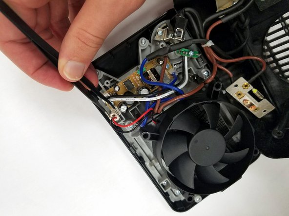

    • Flip your device over so the back panel faces you. You should see a hole containing a screw in each corner of the device.
    • Insert a 4-inch Phillips #1 screwdriver into each hole until connected with the 20 millimeter, sharp-point screw.
  2. Insignia NS-HTMC01-B Fan Replacement: crwdns2935265:02crwdnd2935265:01crwdnd2935265:01crwdne2935265:0
    • Rotate the screwdriver counter-clockwise until screws are removed.
    • Make sure to firmly connect your screwdriver with the head of the screw. A loose connection can strip the screw head, making the screws impossible to remove.
    • Remove the back panel.
  3. Insignia NS-HTMC01-B Fan Replacement: crwdns2935265:03crwdnd2935265:01crwdnd2935265:01crwdne2935265:0
    • Unscrew the four 9 millimeter, sharp-point screws holding the fan in place.
  4. Insignia NS-HTMC01-B Fan Replacement: crwdns2935265:04crwdnd2935265:01crwdnd2935265:02crwdne2935265:0 Insignia NS-HTMC01-B Fan Replacement: crwdns2935265:04crwdnd2935265:02crwdnd2935265:02crwdne2935265:0
    • Use tweezers to disconnect the red and black wires.
    • Remove the fan.
