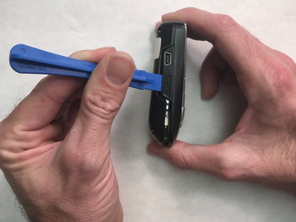

  3. Insignia NS-HD01A Battery Replacement: crwdns2935265:03crwdnd2935265:01crwdnd2935265:02crwdne2935265:0 Insignia NS-HD01A Battery Replacement: crwdns2935265:03crwdnd2935265:02crwdnd2935265:02crwdne2935265:0
    • Use the plastic opening tool to pry open the back cover.
    • Slide the tool around the sides of the radio to gradually pry the back cover off. Do not remove the cover completely as there is still a cable connecting it to radio.

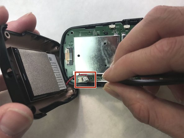

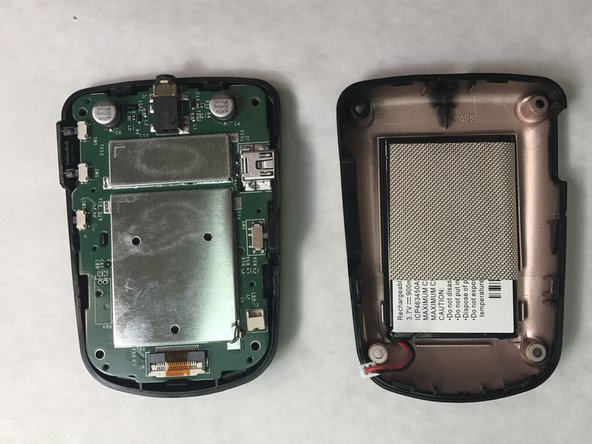

  4. Insignia NS-HD01A Battery Replacement: crwdns2935265:04crwdnd2935265:01crwdnd2935265:03crwdne2935265:0 Insignia NS-HD01A Battery Replacement: crwdns2935265:04crwdnd2935265:02crwdnd2935265:03crwdne2935265:0 Insignia NS-HD01A Battery Replacement: crwdns2935265:04crwdnd2935265:03crwdnd2935265:03crwdne2935265:0
    • Use the blunt tweezers to unplug the battery cable from the PCB board. Grab the battery cable plug from the sides.

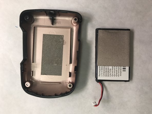

  5. Insignia NS-HD01A Battery Replacement: crwdns2935265:05crwdnd2935265:01crwdnd2935265:02crwdne2935265:0 Insignia NS-HD01A Battery Replacement: crwdns2935265:05crwdnd2935265:02crwdnd2935265:02crwdne2935265:0
    • Use the flat side of the Spudger to pry the battery out of the back cover.
    • Insert the replacement battery into the back cover.
    • Reassemble the radio, making sure to reconnect the battery cable.
