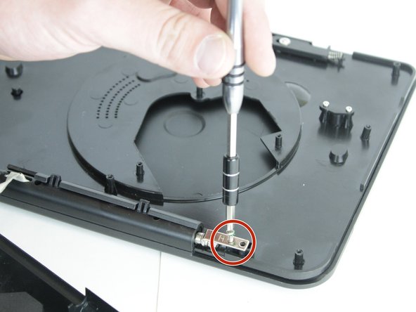

  6. Insignia NS-DS9PDVD15 Speaker Replacement, Disc Tray: crwdns2935265:06crwdnd2935265:01crwdnd2935265:02crwdne2935265:0 Insignia NS-DS9PDVD15 Speaker Replacement, Disc Tray: crwdns2935265:06crwdnd2935265:02crwdnd2935265:02crwdne2935265:0
    • After the back is removed and the disk tray is loose from the bottom, locate the two, 3 mm screws that hold the tray to the hinge.
    • Unscrew them with the JIS #000 screwdriver.

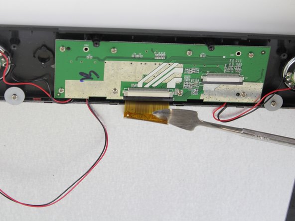

  9. Insignia NS-DS9PDVD15 Speaker Replacement: crwdns2935265:09crwdnd2935265:01crwdnd2935265:02crwdne2935265:0 Insignia NS-DS9PDVD15 Speaker Replacement: crwdns2935265:09crwdnd2935265:02crwdnd2935265:02crwdne2935265:0
    • Once all the screws are removed, pry off the cover with the pry tool.
    • You'll see the PC board, back of the speakers, and the back of the screen.

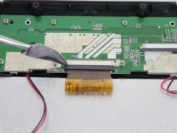

  10. Insignia NS-DS9PDVD15 Speaker Replacement: crwdns2935265:010crwdnd2935265:01crwdnd2935265:02crwdne2935265:0 Insignia NS-DS9PDVD15 Speaker Replacement: crwdns2935265:010crwdnd2935265:02crwdnd2935265:02crwdne2935265:0
    • Remove the ribbon cable carefully with the pry tool.
    • First, push out the black portion.
  11. Insignia NS-DS9PDVD15 Speaker Replacement: crwdns2935265:011crwdnd2935265:01crwdnd2935265:02crwdne2935265:0 Insignia NS-DS9PDVD15 Speaker Replacement: crwdns2935265:011crwdnd2935265:02crwdnd2935265:02crwdne2935265:0
    • Then, push out the 'ribbon' with the pry tool.

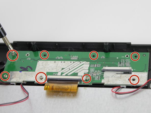

  12. Insignia NS-DS9PDVD15 Speaker Replacement: crwdns2935265:012crwdnd2935265:01crwdnd2935265:02crwdne2935265:0 Insignia NS-DS9PDVD15 Speaker Replacement: crwdns2935265:012crwdnd2935265:02crwdnd2935265:02crwdne2935265:0
    • After the ribbon cable is removed, unscrew the eight, 9 mm screws from the PC board

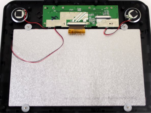

  13. Insignia NS-DS9PDVD15 Speaker Replacement: crwdns2935265:013crwdnd2935265:01crwdnd2935265:02crwdne2935265:0 Insignia NS-DS9PDVD15 Speaker Replacement: crwdns2935265:013crwdnd2935265:02crwdnd2935265:02crwdne2935265:0

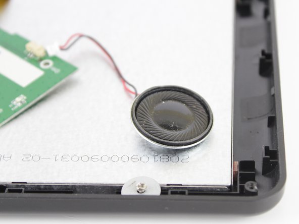

    • Flip over the PC board. Remove the two sets of red and black wires which connect to the speakers.
    • Use the pry tool at the white clip, to remove the wires. Then you can remove the speakers.
    • The wire second to left connects to the screen. Remove the far left wire--circled in the first picture-- to remove the left speaker.
