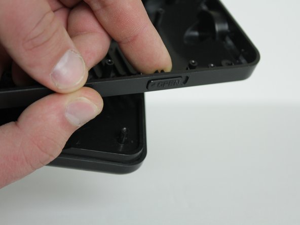

  6. Insignia NS-DS9PDVD15 Latch Replacement, Latch: crwdns2935265:06crwdnd2935265:01crwdnd2935265:01crwdne2935265:0
    • After the back is removed and you can see the interior of the device, push the old latch out.
  7. Insignia NS-DS9PDVD15 Latch Replacement: crwdns2935265:07crwdnd2935265:01crwdnd2935265:02crwdne2935265:0 Insignia NS-DS9PDVD15 Latch Replacement: crwdns2935265:07crwdnd2935265:02crwdnd2935265:02crwdne2935265:0
    • Push the new latch in where the old latch was previously held
    • You can lightly tap it from the inside to make sure the new latch is sliding left and right.
