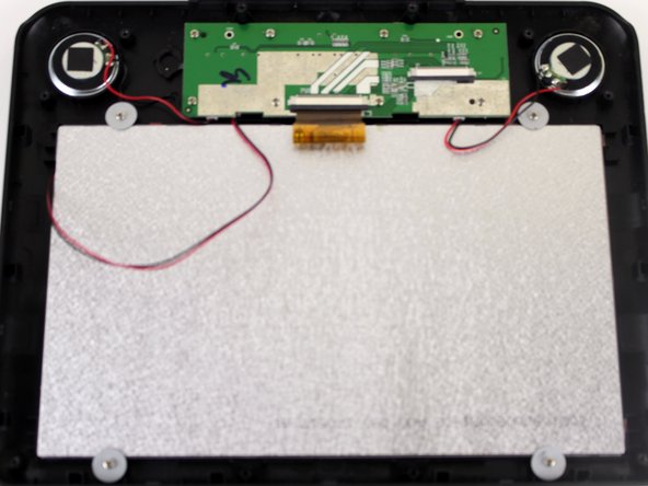

  9. Insignia NS-DS9PDVD15  Screen Replacement: crwdns2935265:09crwdnd2935265:01crwdnd2935265:02crwdne2935265:0 Insignia NS-DS9PDVD15  Screen Replacement: crwdns2935265:09crwdnd2935265:02crwdnd2935265:02crwdne2935265:0
    • Once all the screws are removed, pry off the cover with the pry tool.
    • You'll see the PC board, back of the speakers, and the back of the screen.

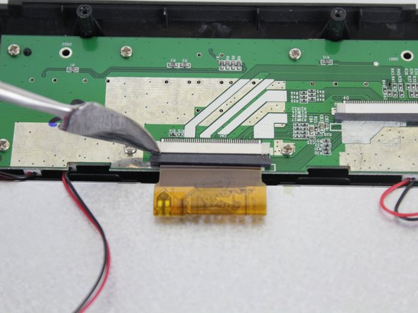

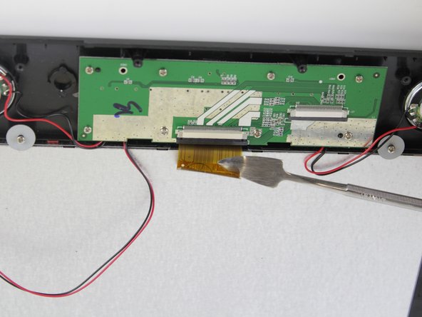

  10. Insignia NS-DS9PDVD15  Screen Replacement: crwdns2935265:010crwdnd2935265:01crwdnd2935265:02crwdne2935265:0 Insignia NS-DS9PDVD15  Screen Replacement: crwdns2935265:010crwdnd2935265:02crwdnd2935265:02crwdne2935265:0
    • Remove the ribbon cable carefully with the pry tool.
    • First, push out the black portion.
  11. Insignia NS-DS9PDVD15  Screen Replacement: crwdns2935265:011crwdnd2935265:01crwdnd2935265:02crwdne2935265:0 Insignia NS-DS9PDVD15  Screen Replacement: crwdns2935265:011crwdnd2935265:02crwdnd2935265:02crwdne2935265:0
    • Next, push out the 'ribbon' with the pry tool.

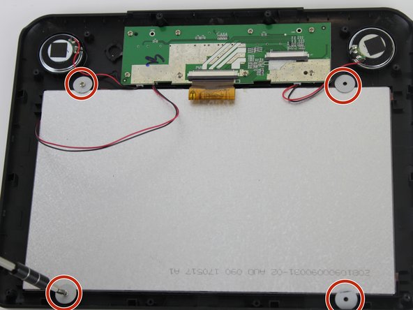

  12. Insignia NS-DS9PDVD15  Screen Replacement: crwdns2935265:012crwdnd2935265:01crwdnd2935265:02crwdne2935265:0 Insignia NS-DS9PDVD15  Screen Replacement: crwdns2935265:012crwdnd2935265:02crwdnd2935265:02crwdne2935265:0
    • Unscrew the corners of screen with the JIS #000 screwdriver. There are four, 6 mm screws with washers.

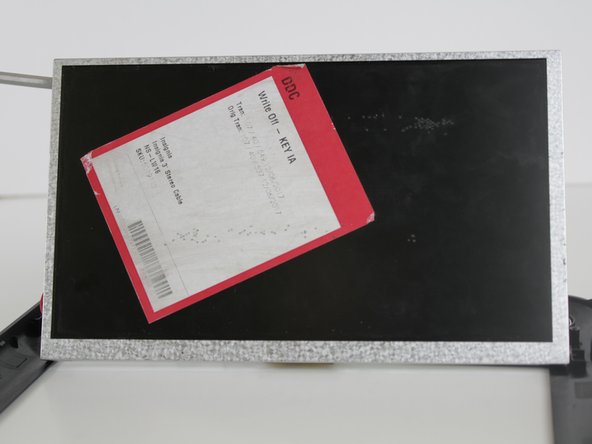

  13. Insignia NS-DS9PDVD15  Screen Replacement: crwdns2935265:013crwdnd2935265:01crwdnd2935265:02crwdne2935265:0 Insignia NS-DS9PDVD15  Screen Replacement: crwdns2935265:013crwdnd2935265:02crwdnd2935265:02crwdne2935265:0
    • After the screws and washers are removed, you can lift the screen off with the pry tool.
