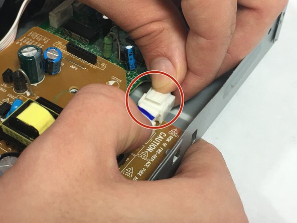

  4. Insignia NS-D160A14 Power Cord Replacement Guide: crwdns2935265:04crwdnd2935265:01crwdnd2935265:02crwdne2935265:0 Insignia NS-D160A14 Power Cord Replacement Guide: crwdns2935265:04crwdnd2935265:02crwdnd2935265:02crwdne2935265:0
    • The power cord's white plastic plug is located on the DVD player's mother board.
    • Unsnap the power cord's white plastic plug from the mother board, and gently slide the male and female white plastic plug connections apart.
    • Be careful not to be too rough when disconnecting the white plastic plug from the motherboard; the motherboard could be easily damaged.
