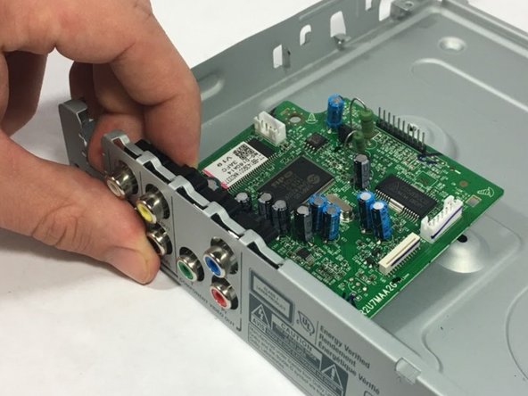

  7. Insignia NS-D160A14 A/V Board Replacement, A/V Board: crwdns2935265:07crwdnd2935265:01crwdnd2935265:02crwdne2935265:0 Insignia NS-D160A14 A/V Board Replacement, A/V Board: crwdns2935265:07crwdnd2935265:02crwdnd2935265:02crwdne2935265:0
    • Remove the two white cables connected to the A/V board from the optical drive using your fingers.
    • Be careful when removing the cables on the A/V board. Don't apply too much pressure, or the wires could be damaged.
  8. Insignia NS-D160A14 A/V Board Replacement: crwdns2935265:08crwdnd2935265:01crwdnd2935265:02crwdne2935265:0 Insignia NS-D160A14 A/V Board Replacement: crwdns2935265:08crwdnd2935265:02crwdnd2935265:02crwdne2935265:0
    • Lift the A/V board upwards until you feel it come free from the indentations in the housing.
    • Gently push on the A/V jacks with your thumb from the outside as you lift the board out.
