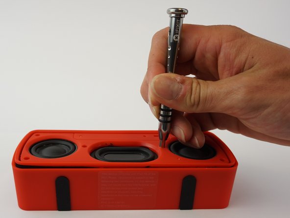

    4. Insignia NS-CSPBTHOL-R Power Button Replacement: crwdns2935265:04crwdnd2935265:01crwdnd2935265:02crwdne2935265:0 Insignia NS-CSPBTHOL-R Power Button Replacement: crwdns2935265:04crwdnd2935265:02crwdnd2935265:02crwdne2935265:0
      • Remove the six 3mm screws using the J00 JIS screw bit. This will require a long, narrow screwdriver.

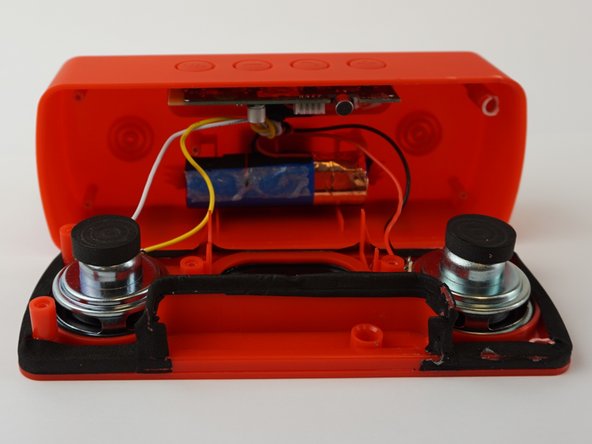

      • Push the spudger into the crevice between the base and the face of the speaker and create a separation.
      • Slide the spudger along the entire perimeter and gently pull off the face of the speaker.
      • The two parts are connected by wires, do not rip them apart.
    6. Insignia NS-CSPBTHOL-R Power Button Replacement: crwdns2935265:06crwdnd2935265:01crwdnd2935265:01crwdne2935265:0
      • Use the spudger to release the battery by sliding it underneath the battery to create a separation.
      • Remove the battery.

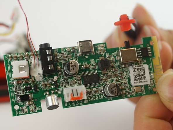

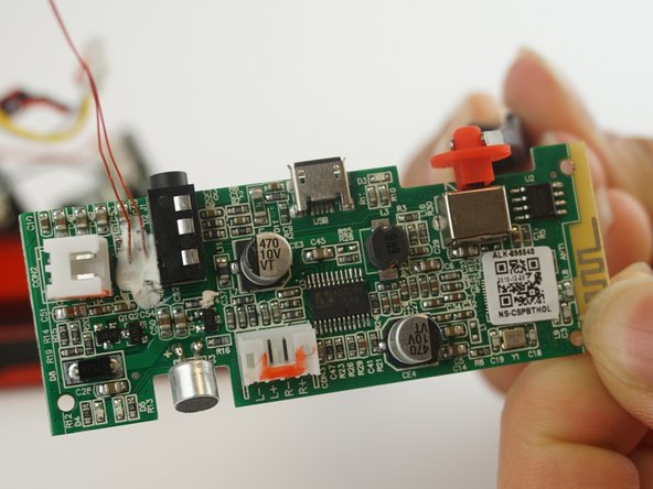

      • Pull the motherboard from the base of the speaker.
      • Using tweezers, squeeze and pull on the white plastic clip that connects the battery wires to the motherboard.
      • Unclip the battery from the motherboard.
    1. Insignia NS-CSPBTHOL-R Power Button Replacement, Power Button: crwdns2935265:08crwdnd2935265:01crwdnd2935265:03crwdne2935265:0 Insignia NS-CSPBTHOL-R Power Button Replacement, Power Button: crwdns2935265:08crwdnd2935265:02crwdnd2935265:03crwdne2935265:0 Insignia NS-CSPBTHOL-R Power Button Replacement, Power Button: crwdns2935265:08crwdnd2935265:03crwdnd2935265:03crwdne2935265:0
      • Using tweezers, detach the power button from the mother board.
