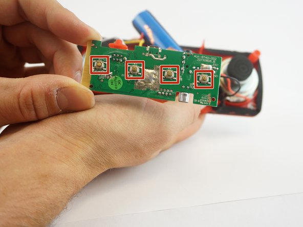

  4. Insignia NS-CSPBTHOL-R Buttons Replacement: crwdns2935265:04crwdnd2935265:01crwdnd2935265:03crwdne2935265:0 Insignia NS-CSPBTHOL-R Buttons Replacement: crwdns2935265:04crwdnd2935265:02crwdnd2935265:03crwdne2935265:0 Insignia NS-CSPBTHOL-R Buttons Replacement: crwdns2935265:04crwdnd2935265:03crwdnd2935265:03crwdne2935265:0
    • Gently pull apart the speaker to separate the speakers from the battery and motherboard. Then pull out the motherboard with your fingers by grabbing the edges and pulling upwards.
  5. Insignia NS-CSPBTHOL-R Buttons Replacement: crwdns2935265:05crwdnd2935265:01crwdnd2935265:02crwdne2935265:0 Insignia NS-CSPBTHOL-R Buttons Replacement: crwdns2935265:05crwdnd2935265:02crwdnd2935265:02crwdne2935265:0
    • Desolder the four contact points from the button that is unresponsive.
    • Check out this helpful guide for soldering and desoldering tips.
