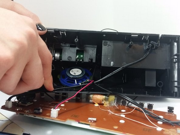

    • Remove the screws from the back panel using a Phillips #00 screwdriver.
    • Gently pull to remove the motherboard.
    • Do not cut any wires when removing the motherboard
  2. Insignia NS-CLOPP2 Speaker Replacement: crwdns2935265:02crwdnd2935265:01crwdnd2935265:02crwdne2935265:0 Insignia NS-CLOPP2 Speaker Replacement: crwdns2935265:02crwdnd2935265:02crwdnd2935265:02crwdne2935265:0
    • Scrape off the glue using an opening tool to detach the speaker from the black clock.
  3. Insignia NS-CLOPP2 Speaker Replacement: crwdns2935265:03crwdnd2935265:01crwdnd2935265:01crwdne2935265:0
    • After removing the adhesive, carefully remove the speaker from the device.
    • Use a technology-friendly adhesive to reinstall the new speaker.
