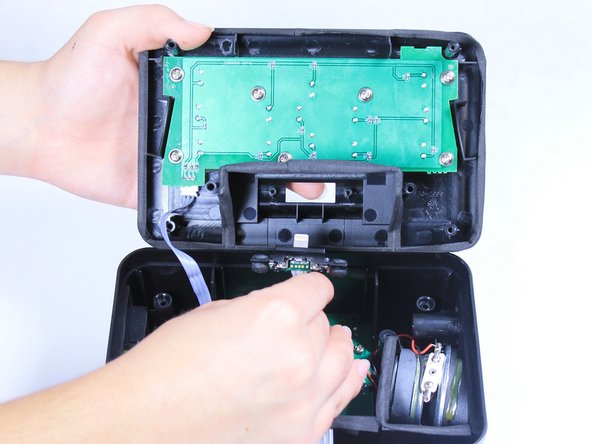

  5. Insignia NS-CLLT01 iPhone Dock Replacement: crwdns2935265:05crwdnd2935265:01crwdnd2935265:03crwdne2935265:0 Insignia NS-CLLT01 iPhone Dock Replacement: crwdns2935265:05crwdnd2935265:02crwdnd2935265:03crwdne2935265:0 Insignia NS-CLLT01 iPhone Dock Replacement: crwdns2935265:05crwdnd2935265:03crwdnd2935265:03crwdne2935265:0
    • Turn the clock back over.
    • Lift the top off of the clock by gripping the back of the iPhone dock and pulling straight up.

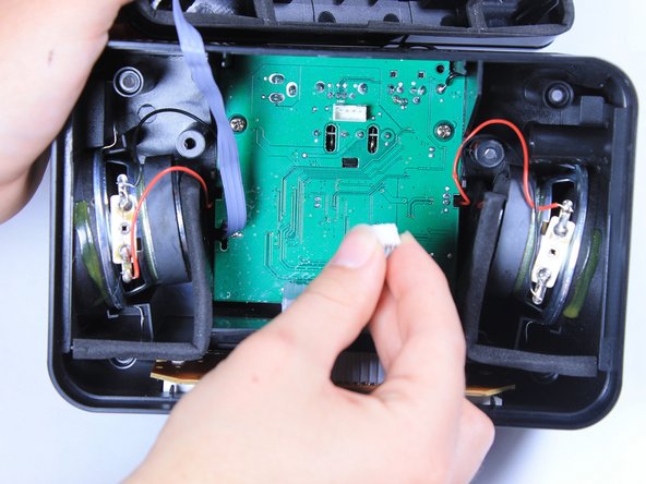

  6. Insignia NS-CLLT01 iPhone Dock Replacement, iPhone Dock: crwdns2935265:06crwdnd2935265:01crwdnd2935265:02crwdne2935265:0 Insignia NS-CLLT01 iPhone Dock Replacement, iPhone Dock: crwdns2935265:06crwdnd2935265:02crwdnd2935265:02crwdne2935265:0
    • Grip the white ribbon cable connector that attaches the lightning cable to the middle of the central circuit board located in the bottom of the clock. Pinch and pull straight up to detach the cable.

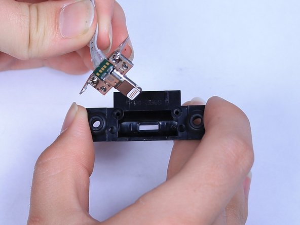

  8. Insignia NS-CLLT01 iPhone Dock Replacement: crwdns2935265:08crwdnd2935265:01crwdnd2935265:02crwdne2935265:0 Insignia NS-CLLT01 iPhone Dock Replacement: crwdns2935265:08crwdnd2935265:02crwdnd2935265:02crwdne2935265:0
    • Remove the plastic casing, which encases the Apple lightning connector, from the top cover of the clock.
  9. Insignia NS-CLLT01 iPhone Dock Replacement: crwdns2935265:09crwdnd2935265:01crwdnd2935265:01crwdne2935265:0
    • Using a Phillips #1 screwdriver, unscrew the two 4mm Phillips screws that hold the metal frame around the lightning connector to the plastic casing.
  10. Insignia NS-CLLT01 iPhone Dock Replacement: crwdns2935265:010crwdnd2935265:01crwdnd2935265:02crwdne2935265:0 Insignia NS-CLLT01 iPhone Dock Replacement: crwdns2935265:010crwdnd2935265:02crwdnd2935265:02crwdne2935265:0
    • Remove the metal frame around the lightning connector from its plastic cover.

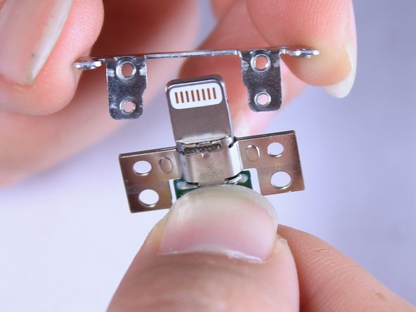

  11. Insignia NS-CLLT01 iPhone Dock Replacement: crwdns2935265:011crwdnd2935265:01crwdnd2935265:01crwdne2935265:0
    • Using a Phillips #0 screwdriver, unscrew the two 3mm Phillips screws from the metal frame around the lightning cable.
  12. Insignia NS-CLLT01 iPhone Dock Replacement: crwdns2935265:012crwdnd2935265:01crwdnd2935265:02crwdne2935265:0 Insignia NS-CLLT01 iPhone Dock Replacement: crwdns2935265:012crwdnd2935265:02crwdnd2935265:02crwdne2935265:0
    • Remove the metal frame from around the lightning connector. This will allow you to replace the lightning connector with a new one.
